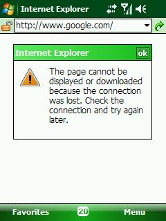

I can't connect to the Net from the 6900. I keep getting "Error Code:1012, Could not prepare Vision services", message when the phone tries to connect to the Net. This happens 99% of the time. Sometimes once in a day it manages to connect though. What could be the issue?
I am running on dharvey's ALMOST OEM 6.1 Sprint Vogue ROM **V.2.1** with Working GPS/Rev A from ppc geeks, but I dont think the ROM is the issue, as I was getting the same errors when I used Hetal's ROM vers. E

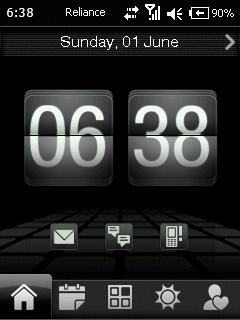

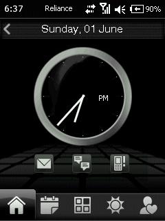

For the time being, till I can get proper Net connectivity, I'll just show off my Touch Today screen running on the HTC Diamond theme ^_^
