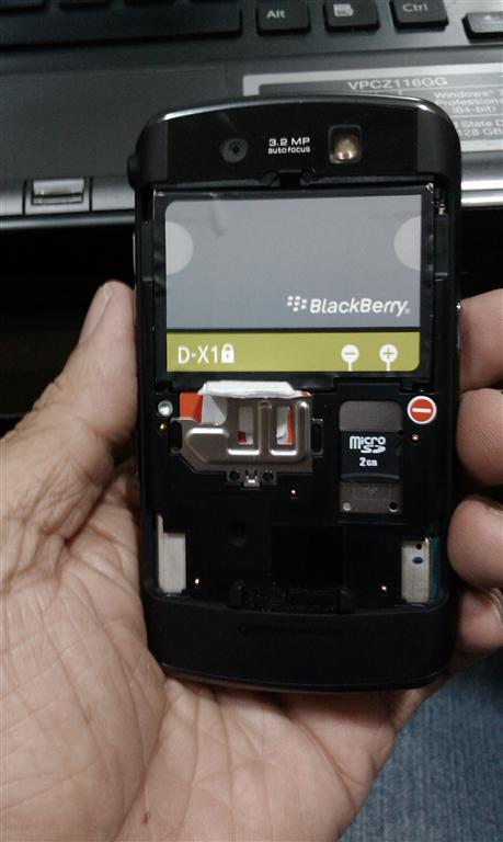

Problem of sim card detection solved, the card was loosely fit so i put a paper folded behind it - SOLVED now the card has been detected, but code not working,

unless phones detects sim it wont show u unlock code box
