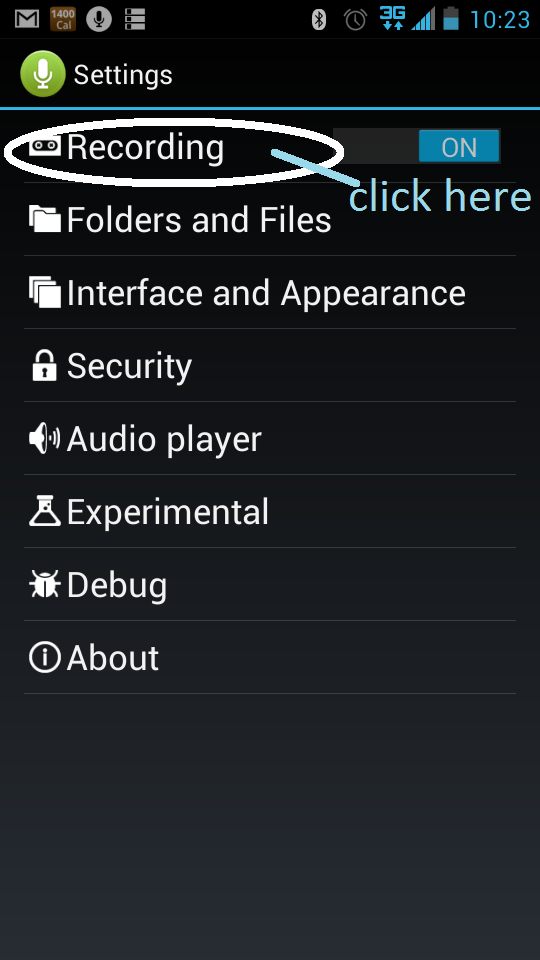

Install call recorder and ALSA

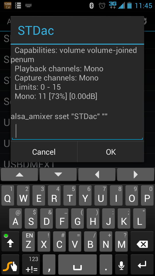

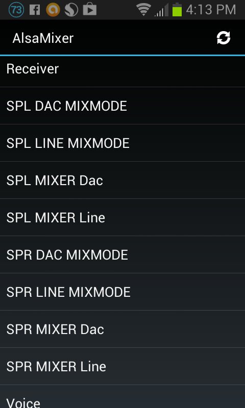

open ALSA and find setting called STDac
Change value, ensure that it is below maximum value mentioned. I assume higher value may damage HW.
As seen it was 11 in my phone, I increased it to 13 and opposite party voice was audible in recording.
Click option and Save Config.
I am not sure - if it is a routine - but on every reboot, my value revert back to normal.

STDac value in my droid razr shows 13, should i try with 14 coz limit says 0 - 15 ?

Nothing called STDac is found. Plz see...
Triggered from SPH-D710
@nitink, try that is the only way. Even if you make 15 will not make diff as system is designed to handle that value.

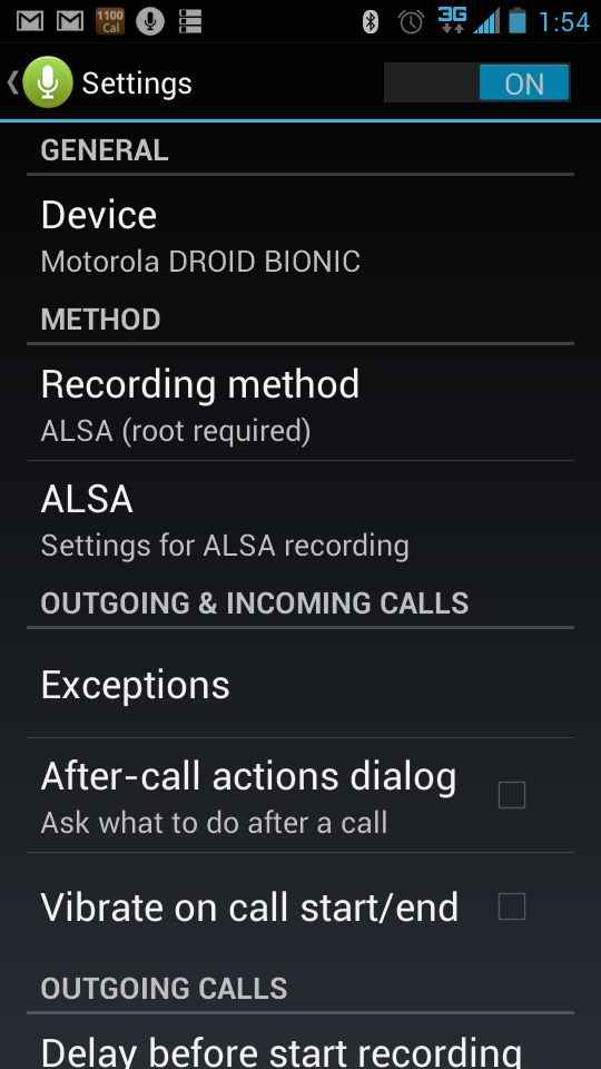

Select handset as DROID BIONIC, ROOTED handset and ALSA installed. It is working on my MAXX 98.72.16, XT912
from the master himself regarding xt912
This phone doesn't support 2-way call recording at all.. But there's way to record calls from the microphone (only your side will be recorded):
1. get root access
2. install ALSA
3. set device to motorola droid bionic in the settings->recording->device

kshah ji,
May be I am using the latest version of those apps and the settings are NOT available (like to select phone models, method)... Please email me those apks (I have purchased them anyway -- so its NOT like warez imho.) Further I will then make it a system app using Ti-Bk-Pro to avoid or atleast revert back to it when updated via play store accidently.
