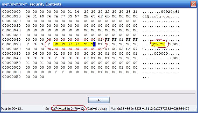

6. See the nvm_security See the Hex Address 74 to 79 The Six Digit SPC is written over there.

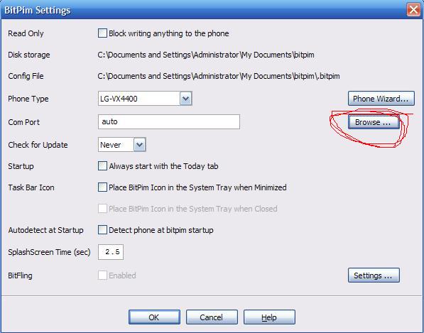

Selecting Setting Menu in Bitpim
Selecting Browse for Serial Port Menu

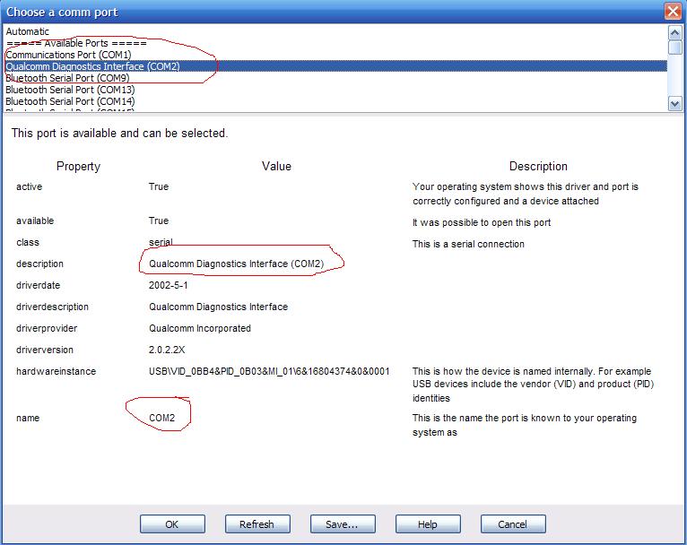

Selecting Qualcomm Dignostic Interface

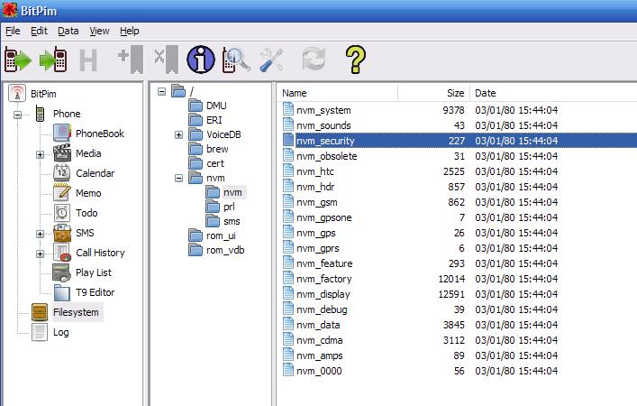

Exploring the File System
Finally Getting SPC from nvm_security file

5. Start Bitpim and Connect the Phone using Appropriate Serial Port and Explore File SYstem.
