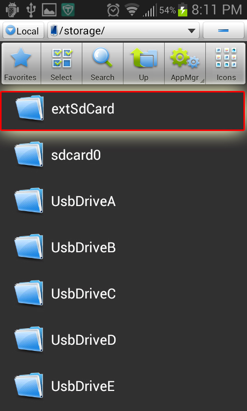

Just Flash the ROM again. faced the sd card wipe out issue....STRANGE.
but able to get back the data.
post-69747-0-29089900-1354891604_thumb.j
all SD Card data is stored in a different folder.

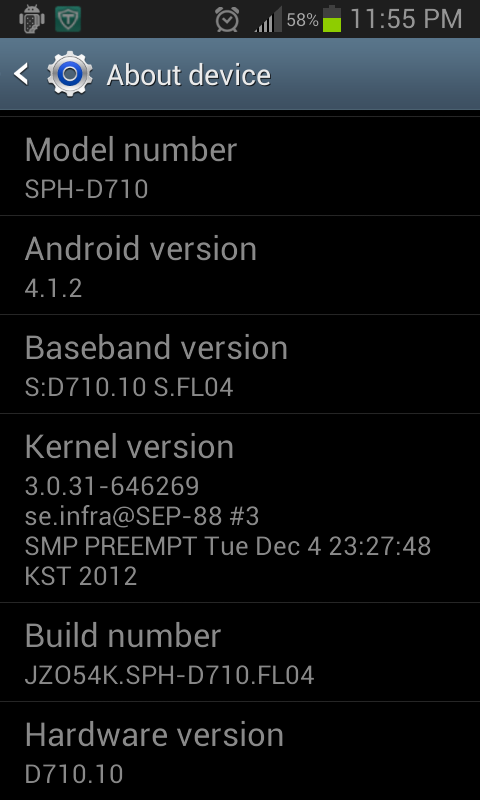

FL04 , new leak for Epic Touch
I didnt notice any chnage ( If you arent that acquainted with flashing and all , you can easily skip it ), but they say some minor bug fixes were done
here are the One click odin versions
Rooted RESTORE One Click File : WILL WIPE EVERYTHING
http://rwilco12.androidfilehost.com/LeakSite/Leaks/Samsung%20Epic%204G%20Touch/FL04/ROM/Rooted/SPH-D710_FL04_646269_Rooted_Restore.exe
Rooted NO data wipe Version ( recommended ) : will keep all your data intact - this is the one i have been posting all along.
http://rwilco12.androidfilehost.com/LeakSite/Leaks/Samsung%20Epic%204G%20Touch/FL04/ROM_NoData/Rooted/SPH-D710_FL04_646269_Rooted_Nodata.exe One
Just switch off phone
Hit Power + Vol Down
once download warning screen appears
hit vol up
open the One click exe file on pc
plug in the phone
phone will show as a yellow box on one of Com ports
hit start
take a nap
and you are done .
