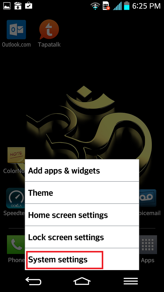

Access phone settings
post-81420-0-50663400-1396358811_thumb.p

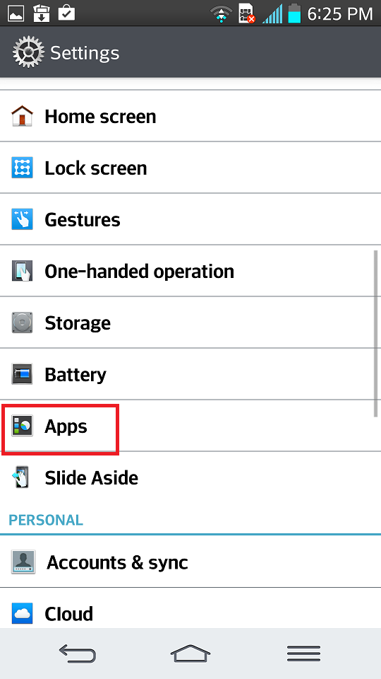

Access Apps
post-81420-0-65273900-1396358004_thumb.p

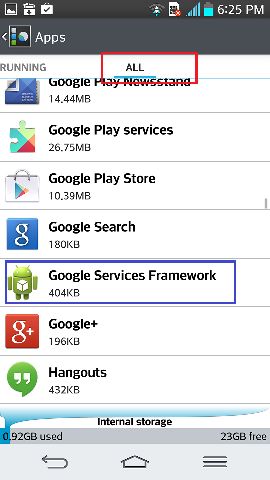

Go to all, In all access Google Services Framework
post-81420-0-14478700-1396358011_thumb.p

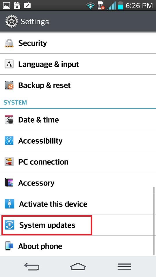

Access System Updates
post-81420-0-92894500-1396358017_thumb.p

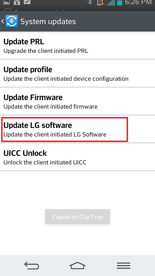

Access Update LG Software
post-81420-0-44751900-1396358023_thumb.p
You Should get a screen with dates 1/1/1970,
In the same screen Check for update. now i dont have that screen since i got the update after many tries.

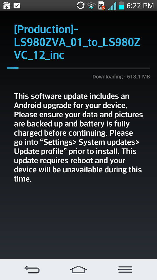

Got the update by Force
post-81420-0-20976500-1396358029_thumb.p
I got this after a few tries, just keep doing it till you get it.

I have rooted gsm unlock sprint lg g2 zva today i got ota update
Downloaded 618 mb but not install update yet
Please suggest what to do
i have also same problem please tell us if someone have solution.
Even i have the same problem i downloaded the update to ZVC thrice and after the automatic reboot still it shows 4.2 as the software version. I am still wondering what happened to the download which was around 618mb
both of u
I actually carelessly gave it a shot n that 618mb update is not kitkat update
u will still b on 4.2 android
