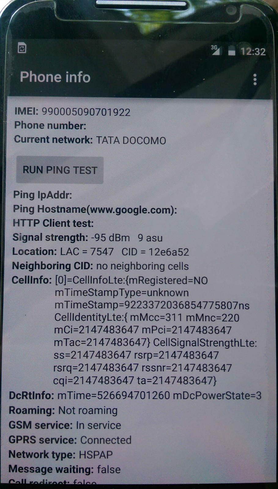

Doctor on a spree. I tried on moto x 1st Gen and was successful in getting gsm signal. Calls sms working fine. Data somehow not working.

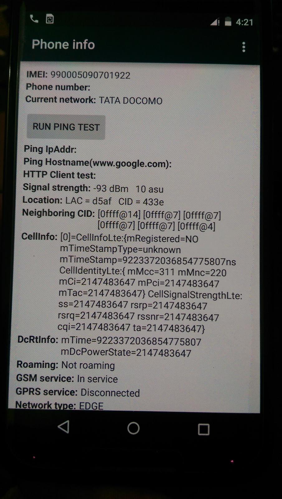

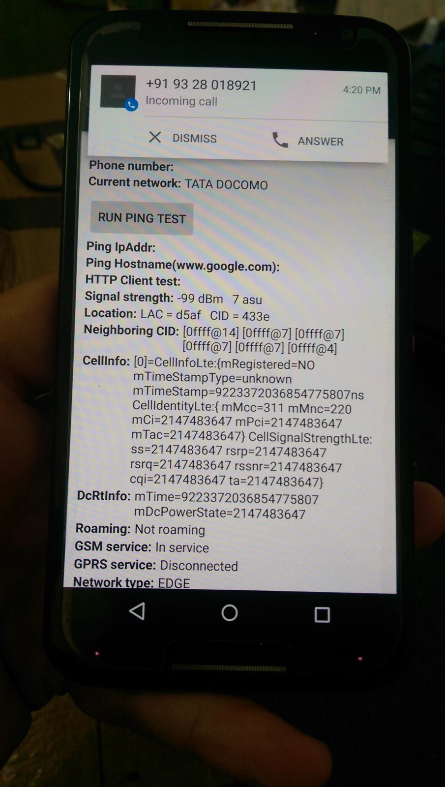

Okay, i tried all these steps on moto x 2nd gen us cellular. To get LTE menu i flashed it with android 6 firmware of moto x pure edition. I can scan all gsm and jio lte network, however unable to latch on any network. Tried with mtnl, vodafone and airtel sim cards and reliance sim as well.
The problem may be due to fact that it always shows network locked symbol at the beginning and asks for unlock code which i dismiss. But that thing may be preventing phone to lqtch on to a network.
Any help will be appreciated.

Some handsets have perso SHA network lock. Tried XT1056 method of flashing the nv items but that didn't help. I am expecting help on this. Can try any NCK unlock code method. Will update shortly.
Sent from my K016 using Tapatalk
I think I have the answer now.  Did some research on net. XT1093 model number is shared by three operators, ntelos, carolina west wireless and Us cellular. While first two are NV unlocked, the US cellular one is sim locked via some nv settings. That's why we are able to scan network but unable to latch on it. Correct me if I am wrong.

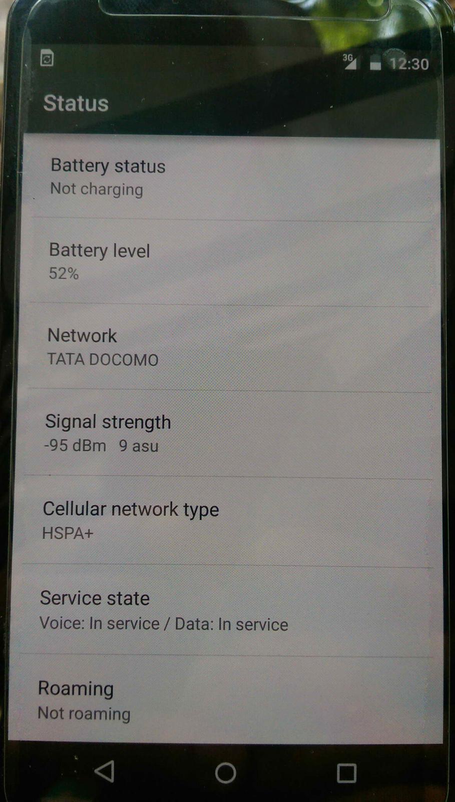

New updated unlock values for XT1055
In QXDM (airplane mode-no sim inside)
1. 441=899 or 903
2. 946=0
3. 1877=899 or 903
4. 2954=0
5. 4548= 899 or 903
XT1055 has a problem of reverting back to LTE/CDMA auto after the above because of some build.prop restrictions. Use a modified version of Verizon Moto E XT1528 adb commands.
adb shell
pm clear com.android.providers.telephony
settings put global preferred_network_mode 3
settings put global preferred_network_mode1 3
settings put global preferred_network_mode2 3
6. Turn off Airplane mode
7. Power off and Restart the phone
This phone builds sim database in telephony.db upon every sim insertion. Each time we insert a new sim, we have to use the commands. Though with the original values of QXDM, 4G LTE works, it is not very stable. The phone goes back to LTE/CDMA auto if all CDMA/GSM/WCDMA/LTE bands are unlocked. With these modified values we ensure GSM auto prl works even after soft reboots.
For XT1093 I will upload partitions of fully unlocked phone in the coming days.
