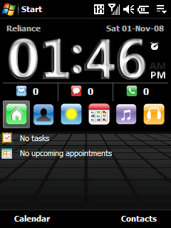

Edit 3
Added Screen Shot and software (kindly remove .zip in front of the cab file and use it)
