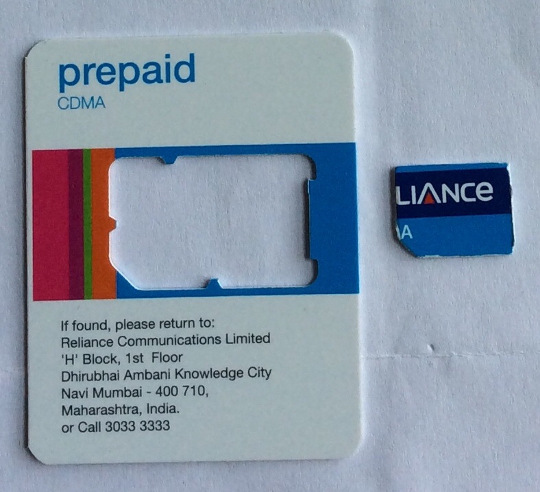

I will Try to find new uncut mini sim ,already in use old OMH mini will work after cut....
Sent from my Micromax A76 using Tapatalk
Yes pre cutted micro sim have some issue.
Tried with three sim 1 micro sim no data, on 2nd micro sim 1x worked, 3rd mini sim cut to micro sim worked both evdo and 1x
Thanks for your support and thanks to rimweb

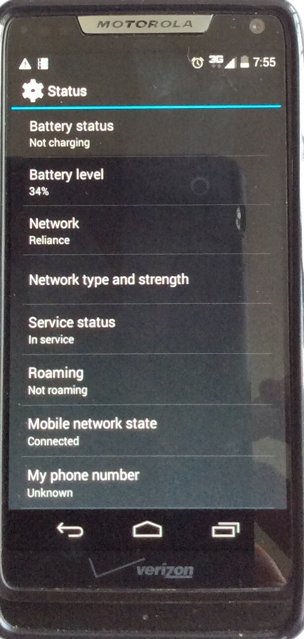

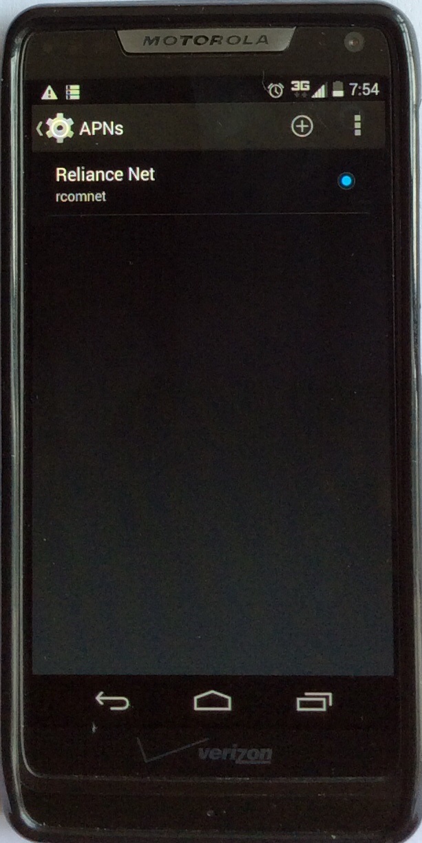

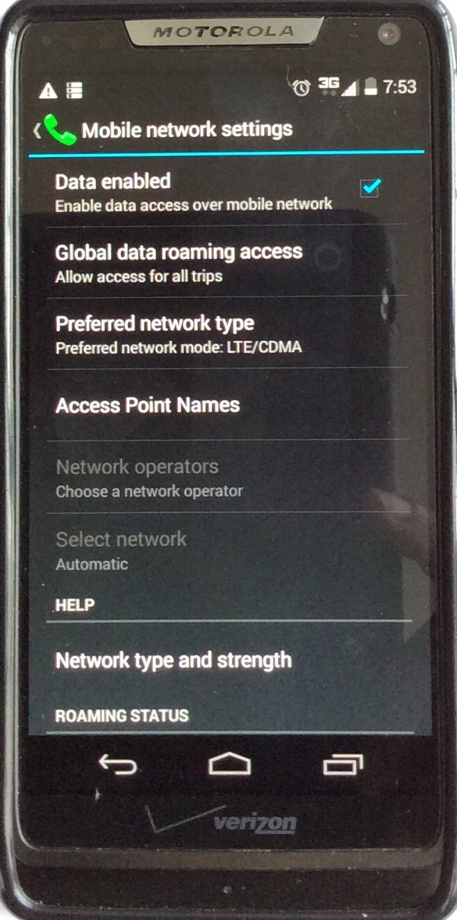

Hi,
I had the same issue after upgrading to kit kat 4.4.2.
Simply, to try my luck, I went to reliance store a bought a new OMH sim for Rs 4/-.
To my surprise when I inserted the new sim, I got an option to add APN.
I created a new rcomnet apn and gave my mobile no. as username and password.
After a few seconds I was connected to evdo network. To my surprise, with the new sim, wifi tethering is also working without any Verizon subscription check.
Snap shot Plz

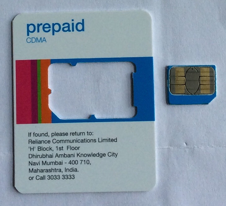

@Nibin please send photo of ur ruimcard
Sent from my LG-LS980 using Tapatalk
Here you go.
post-30610-0-56221100-1403318472_thumb.jpost-30610-0-33044900-1403318488_thumb.jpost-30610-0-00444300-1403318502_thumb.jpost-30610-0-30273200-1403318512_thumb.jpost-30610-0-85949200-1403318523_thumb.j
This is the same designe ruim card which was work for my razr m.
Thanks this is helpfull for others.

@tanvir not work all ruim. Work only ruim that seen in pic
Vijayji,
WHat is the difference between the one seen in pic
Here you go.
attachicon.gifimage.jpgattachicon.gifimage.jpgattachicon.gifimage.jpgattachicon.gifimage.jpgattachicon.gifimage.jpg
PLease let me know.
I will try and locate my SIM package.
THanks,
No idea what is differance but data works in perticular sim

Pre cutted micro sim work with evdo data..i tested.
Sent from my GT-S5360 using Tapatalk 2
