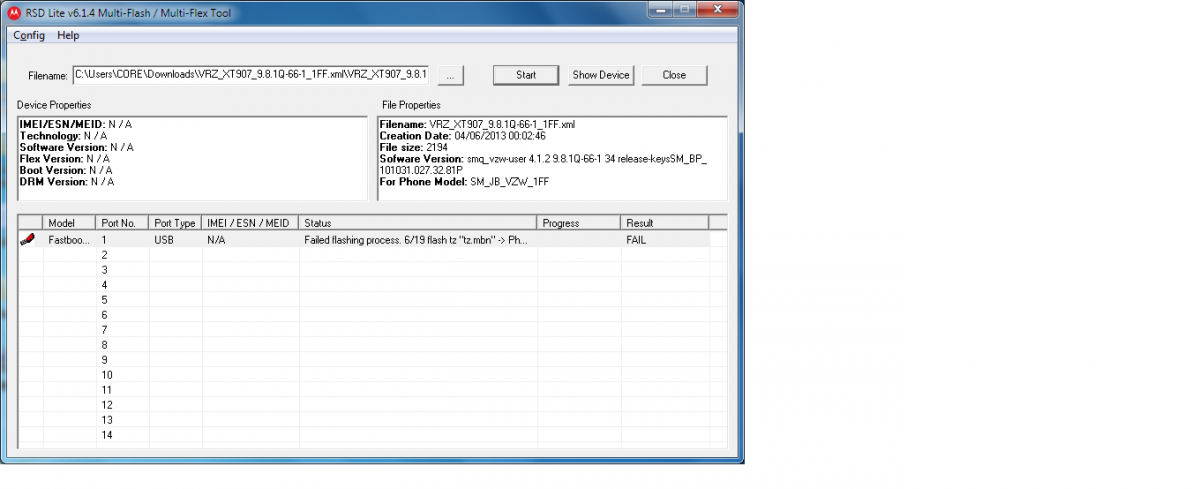

Got eror in rsm lite when connected mobile using AP FASTBOOT, need urgent solution.
When I am try to flash rom using fastboot with rsd lite seen this type of error below image
post-29638-0-29780500-1386160893_thumb.p
have you tried 4.1 rom file ?
Edited by ::Hitesh::
Hiteshbhai actually my phone is not connect properly to rsdlite it was not shown model no.of phone.
Have u tried using different drivers / rsd lite / PC etc ?

@Hitesh
Try Other rom Get below error message screenshot attach
