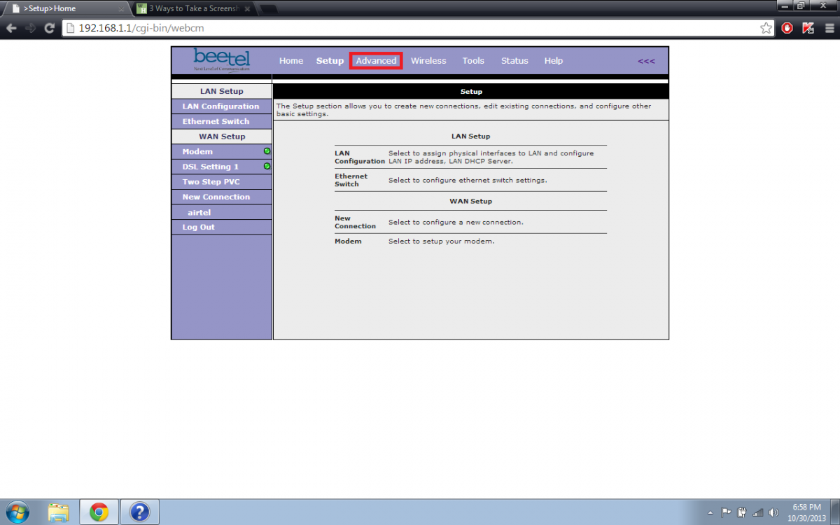

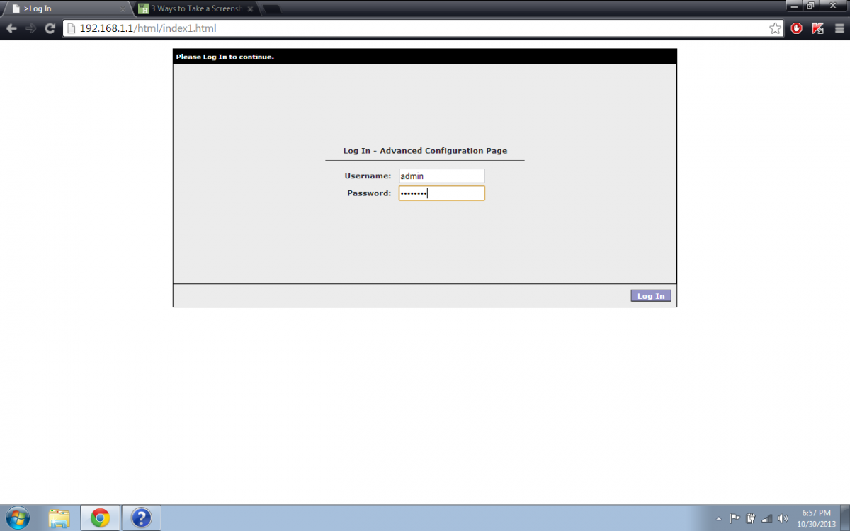

For advanced configuration one has to type 192.168.1.1/html/index1.html
post-81420-0-99410200-1383141628_thumb.p

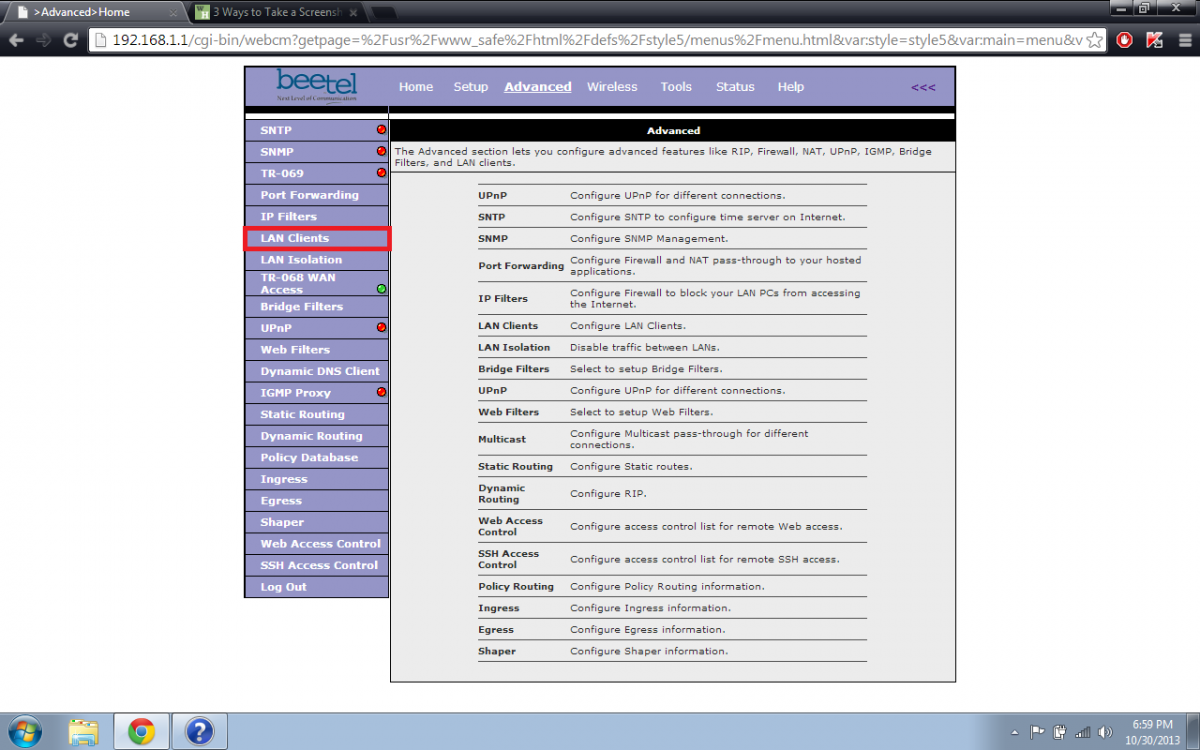

Select Advanced In The Main Menu
post-81420-0-03348400-1383142723_thumb.p

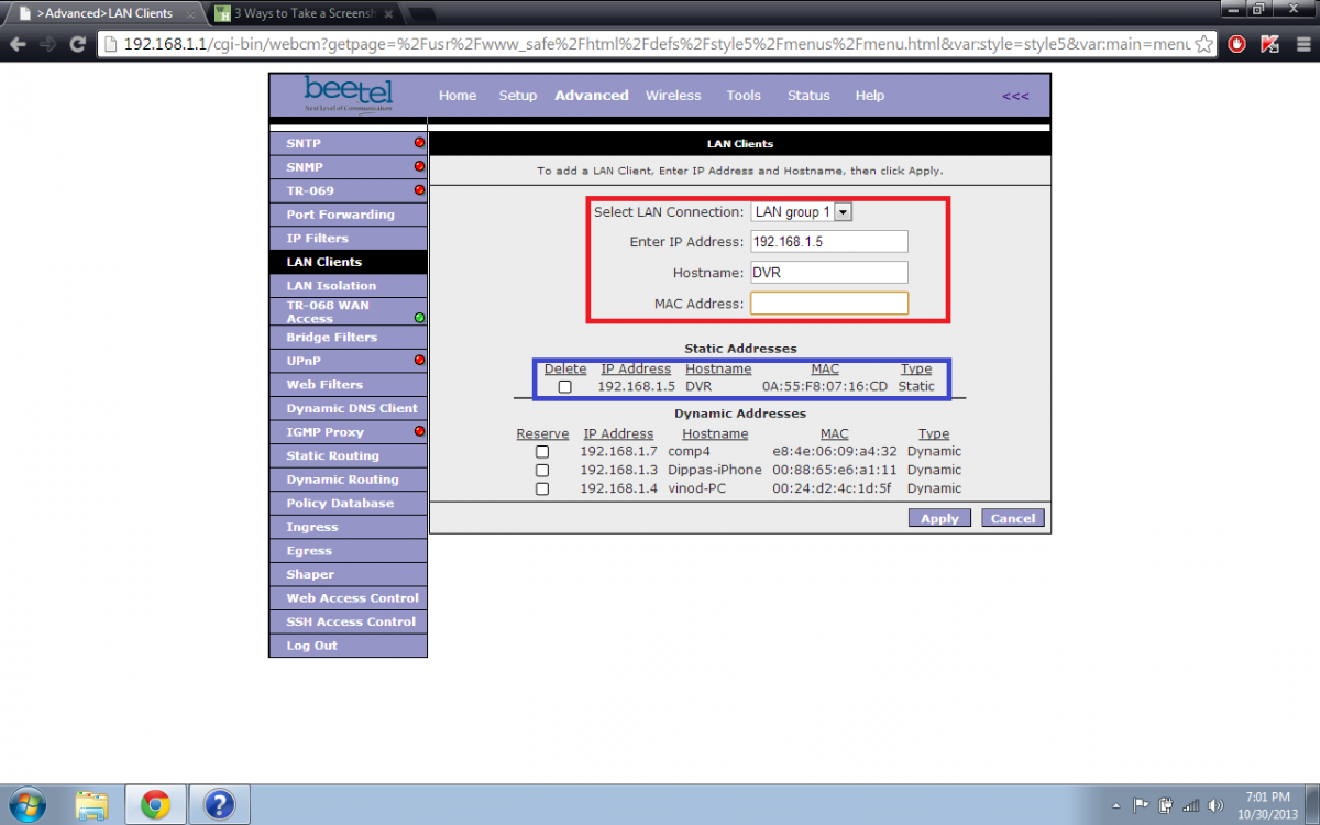

Under Advanced Select Lan Clients
post-81420-0-57052600-1383142759_thumb.p
Select Lan group 1 and enter your INTERNAL STATIC IP of DVR
in my case its 192.168.1.5 and name it anything you want (DVR in my case)
One added it will show like i have marked in BLUE
post-81420-0-43505800-1383142895_thumb.p

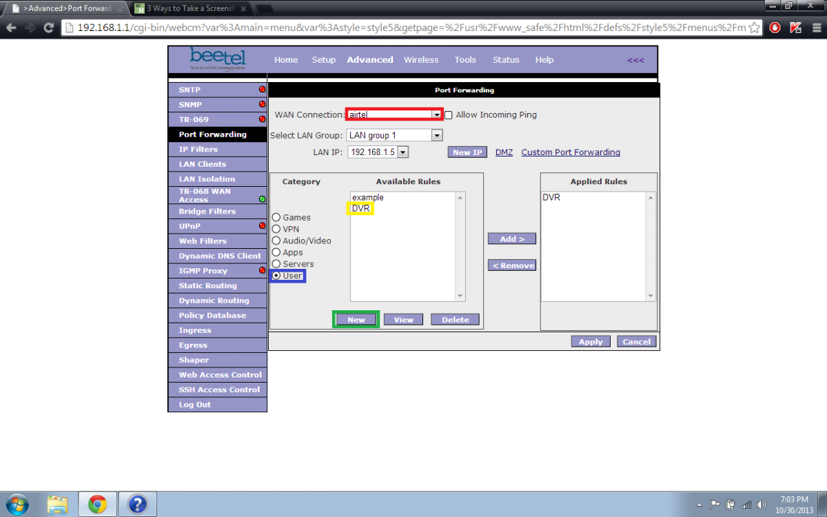

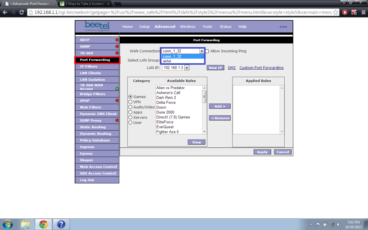

Now Select Port Forwarding On The Left Side Menu Shown in Red
and then the appropriate WAN connection in BLUE
post-81420-0-25178900-1385132920_thumb.p

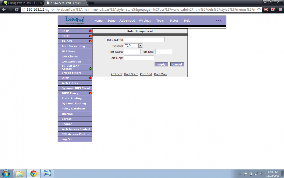

In My Case Its Airtel, Under Airtel Select User Shown in BLUE & Select New Marked in GREEN
post-81420-0-91185000-1385132987_thumb.p
This Is What You Get
post-81420-0-75691800-1385142651_thumb.p

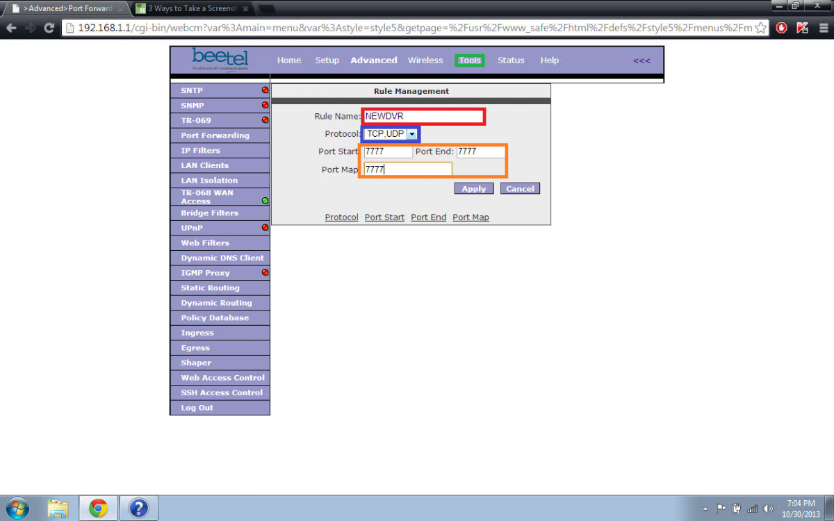

The Enter RuleName "DVR" or "NEWDVR" As Shown Marked In RED
Select TCP/UDP Under Protocol Marked In BLUE
Port Start 7777 Port End 7777 & Port Map 7777 As Shown Marked In ORANGE
Also Add One More Port For Mobile Devices, In My DVR The HTTP Port Is 7777 and Mobile Port is 8888
So Make Sure You Add 2 Ports Here According To Your DVR Settings
post-81420-0-95513900-1385133017_thumb.p

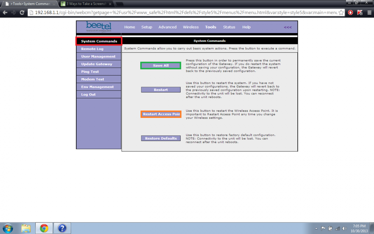

Now Save it And Select Tools Marked in GREEN in Main Menu
Under tools select System Commands marked in RED then select Save All marked in GREEN
And finally select Restart Access Point marked in ORANGE
post-81420-0-01360300-1385133023_thumb.p
That should restart your router and your DVR should be online now.

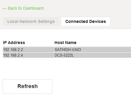

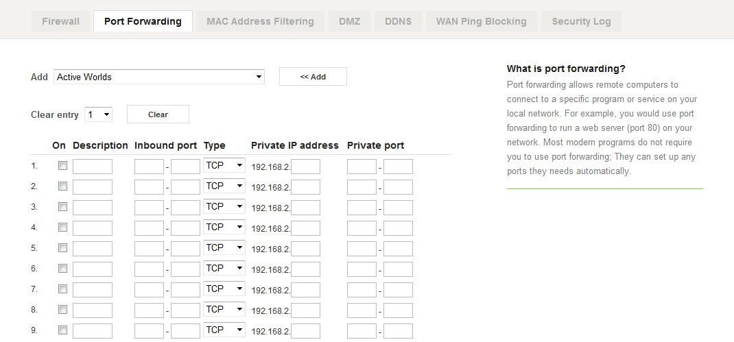

Please find my configuration given below screenshots, Cam and Router are in same IP Range.
But I dont know how to enter Public Static IP to my Camera.
post-64274-0-58193300-1383103802_thumb.j
post-64274-0-62068500-1383103804_thumb.j
post-64274-0-19680400-1383103807_thumb.j
First, you check internally whether you can access the camera from browser or not.. using 192.168.2.xxx
The staic IP will be on your Tikona router. Now set up port forward on Tikona. I don't whether it is allowed on it or not. Earlier they had very weird customised firmware on their device. Check the DLink manual to see on which port it is working. Open that port on your Tikona router and forward it to Dlink camera..
