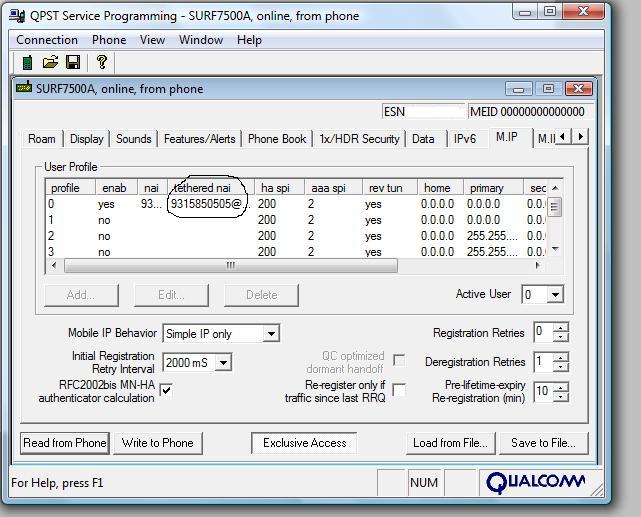

hi guys i have done everything mentioned in all above post ,, i have install Juggalo rom 6.1 , with MK-data file , change my MIP settings to SIP only .. i m also posting the MIS setting image .. user name is UTS@relianceinfo.com pass : 14gE7DW ... but when im trying to connect it it says wrong user name or password .. please help me out guys ..
its showing this is MIP profile /..
NAI : 9315850505@mb.telusmobility.com
9315850505@1x.telusmobility.com
pw is supposed to be i4gE7DW; u may also try using username: sam1 and password: password (thats also chargeable now btw)
Tried but no sucess ... same result wrong user name or password.
set up a connection manually
tried same result... please help me out .... does it have anything to do with MIP settings i have posted ..post-47631-125638915659_thumb.jpg
dude u dont have to do so much
leave profile 0 as it is , dont touch it , it sets provisioning
What should i do then please help me ... :(:confuse:
:Contento: :Contento: :Contento::Sorprendido: aha atlast internet is working on my mobile .... thank you Mr. mufaddal_km
