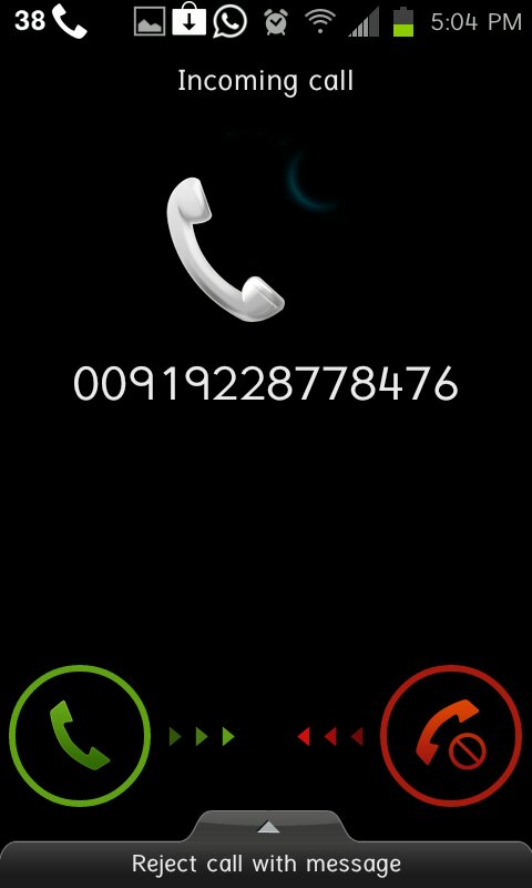

Hi friends,
needed some valuable help
m using s2 e4gt on reliance.
what i have been observing is that sometimes when i receice calls, it shows"0091" in the beginning and then the 10 digit number.
And sometimes it does not show 0091 .Instead shows only "0" and then the 10-digit number.
Resultantly, whenever "0091" is prefixed, the contact name does not display.
Any help or suggestion shall be highly welcome
Thnx..
Ankit ..try prefixer ..its a free app

Thanks for the suggestion. But I myself dunno which number to prefix with 0091 and which not to.
Any idea anyone if changing radio or prl could be of some help?
Mostly this is happening when I receive calls from Vodafone numbers.
Edited by ankitdaluka
You can try to replace 0091 with 0 or with +91. Try it. It should work.

No no. Actually all numbers are stored in my address book with 0 prefix only. So prefixer would change it to something other than 0. May be 0091 or +91 but the problem is that I myself dunno which number would show up with prefix 0091 when call comes. So I don't know which number to prefix with 0091 and which not to.
However I will try prefixing them with what u have suggested and will let u know. Thnx
Tried prefixer.
With ur settings.
It shows prefixer is on but still does not edit the numbers when call actually comes. It still shows 0091.
Thnx for the response though.
This issue mainly with calling vodafone

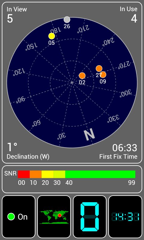

My GPS. Any solution?
In gps test click on menu and then Update AGPS
Weneva I used use gps until now on this handset with Evdo on I always got innacurate location. Hardly a month since I bought s2 cdma. Just checked. The gps does not lock. Even for hours.!!!!
Tried gps test app.
Tried clearing and updating AGPS but no luck.
Without this Google maps is of no use. I Googled. It's a common problem. If anyone could throw some light shall be grateful. Thnx

For GPS fix follow dkail's post.
Tried it. Four to five times. Fon din restart. So manually restarted. But no development.
Ankit here is the post
Thnx for the help amit ji.
I already located the post. But after trying the method the fon din restart. After manually restarting also there was no gps fix attainable on my fon.
