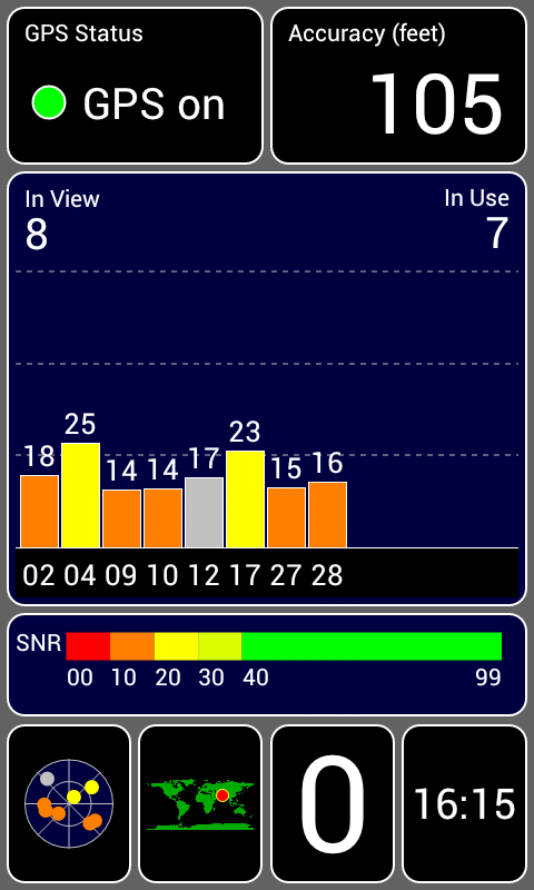

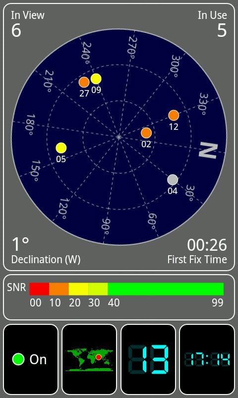

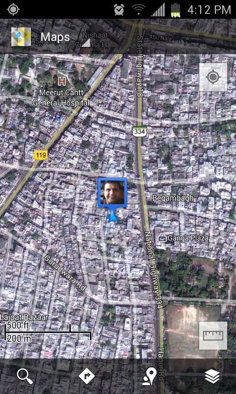

There seems to be a GPS issue. Got only 2 satellite fix after waiting quite a bit and did not lock. Looking for solutions. AGps and location working perfect. Battery life is same. I find no change.
OK, I fixed the GPS issue after official ICS update by this -
1. You should know your MSL (usually 000000)
2. Launch phone dialer and dial ##GPSCLRX# (##4772579#) This will clear and reset your GPS
3. Enter the MSL as the password (000000)
4. Your phone will automatically reboot. If it does not (mine didn't) reboot your phone.
5. Once booted back in the ROM open Maps or Navigation or GPS test application and obtain a GPS fix (This is an important step!)
Screen shot after GPS fix attached
post-18748-0-62750200-1344509593_thumb.p post-18748-0-58590600-1344509596_thumb.p
@vishalseth - Now enjoy and say thanks...

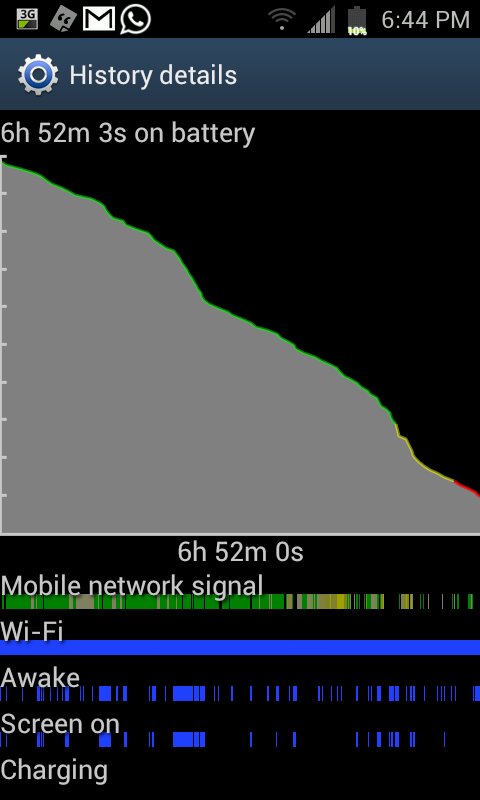

I was successful in upgrading to ICS. The battery drain was heavy. I updated when battery was 100%. Finally it was 20%. GPS test is not getting locked. Google maps is getting location but it fluctuates.
I'm attaching my current battery status.
Edited by vishalsheth
Try and use sfhubs 1 click ics Odin file to flash the ics rooted ff18.
It works like a charm.
Give it three full charge and drain cycles , you all be good to go.

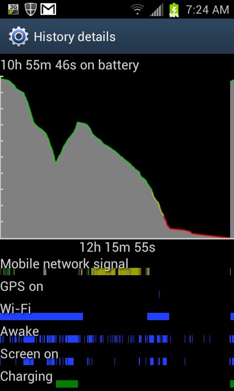

I've completed the 3 cycles are over. Screenshots attached.
Cycle 2:655
Cycle 3
Still the battery performance is bad. I'm at 4% now. All cycles I've let it die. Also charging was done with phone switched off. Cycle 2 may look better as it was night time & phone was not used much.
Reflash gb
Its a general belief that ics seems to be having a bad battery life on epic touch.
