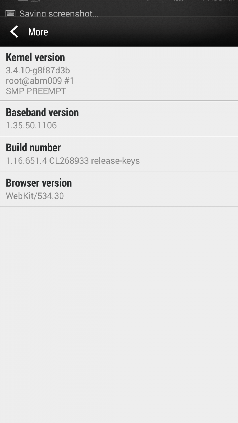

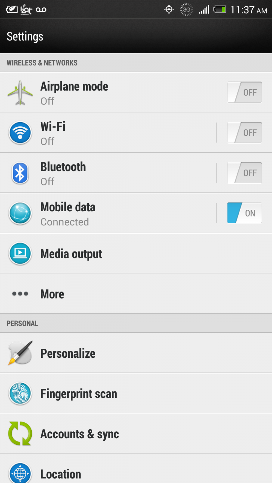

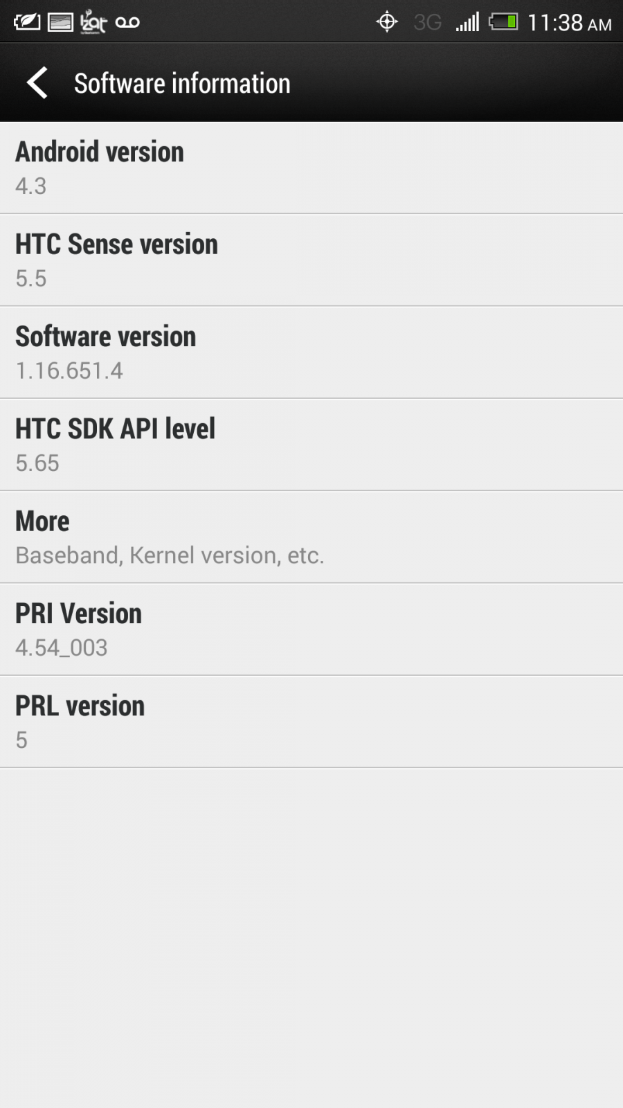

post-79633-0-07115900-1397456440_thumb.p
post-79633-0-94001200-1397456468_thumb.p
post-79633-0-42450400-1397456596_thumb.p
