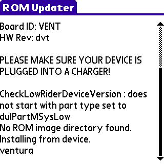

4. Install ROM tool you downloaded and see all option, in rom source select option as shown in image. in output rom type name ventura and output type ZIP+MD5, it will create ROM files for you one zip and one MD5
5. create new folder in your treo memory card root named ROM and copy both files to folder.
6. Install RomUpdater.bprc (Rename it to PRC) and RomUpdater_enUS.oprc on main memory of your treo.
7. Run ROM updater in palm, you will see some text and then type "ventura" on your treo. (See screen shots) Be patient, it will take 15-45 mins Once done your ROM will be sprint rom and you will be able to see all menus using ##codes,, your codes will be ## instead of #*#
I have started the flash process.
Thanks for sharing the views. Its very very useful.
So far, I have got the same messages except one i.e. your image says "No ROM image directory found"
I got "ROM image directory found on card"
Rest all messages are the same.
Had you not shared the views, the last 2 messages would have been confusing i.e.
"ERROR: Aborting update
Error (0x0007): Can't find file"
But as suggested by you, I will be patient, wait for 45 minutes for this to be completed.
BTW, What message would come when it is completed? How would I know that the process is over? Would it reboot on its own?
Update:
The flashing ROM did not work.
Waited for over an hour and nothing happened. Maybe the error indicated is correct and aborts update.
