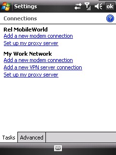

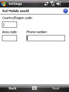

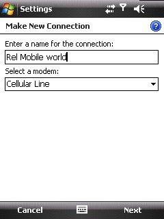

Dear Friends,
My bro is facing problem in getting internet net active through Reliance World.
I did this above setting on my cell phone its getting active, but when i do the same setting on my bros cell it not working.
And today i am getting this wired thing, please help.
In SCREEN C. you will that it is asking for Area Code and all.
Please help

Dont create Add a new modem connection; Instead on the first screen click on Advanced-Select Networks-New-Enter a name like Rel Mobile World2 on General Tab-Then Click Modem-Click New-Enter a name like Rel Mobile World2-Next-Enter #777-Next-Enter Username (UTS@relianceinfo.com) and password (i4gE7DW) -Click Finish;
Thats it, you have created a new connection by the name of Rel MobileWorld2; Now set it as default by ensuring that it iis the selected network in Network Management tab for Programs that automatically connect to the Internet should connect using: tab... Also configure the My ISP connection using the same procedure and edit the Phone as Modem with the same username and password, so that you can seamlessly also connect to the internet on your laptop using the mogul...
