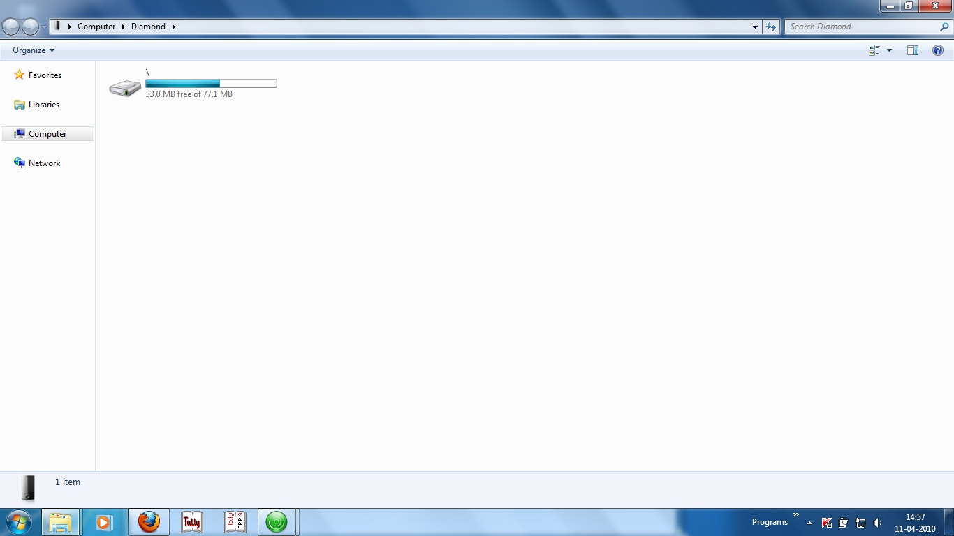

@ Yes, Dr Muffadal, I can, but there also I see only the flash memory of 256 MB and not the 4GB internal storage. Tried WM6.5 also, no help. I have read some where that connecting with Mac can help, I will locate one and then try connecting with that.
Edited by tarun_kabra
seems there is some damage to ur 4gb flash memory
coz nothing is detecting it
It seems very sad , I think I have to go for a new phone now.

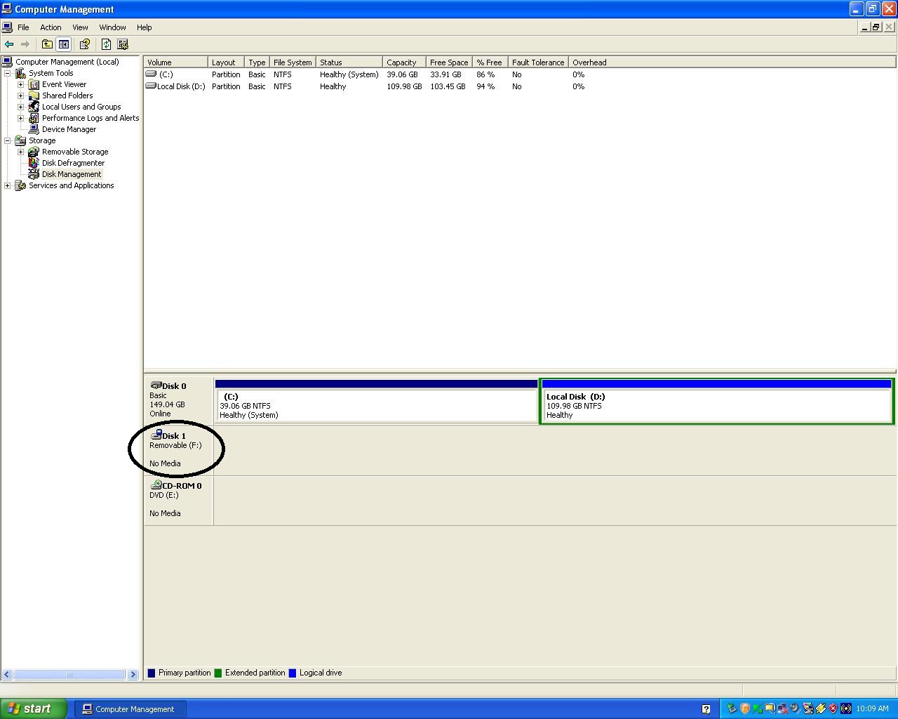

Sumit, first of all thanks a lot for searching all the stuff, though that didn't help me unfortunately. As I had already given try to the disk management option in my Win7PC but today I again tried that option in WinXP (both SP2 & SP3). It shown me messages like - Installing drivers and drivers installed successfully. In the disk management, It shows me a new drive "F" but without any media/storage as normally shown in case of an empty card reader or empty DVD drive. The only better thing with WinXP is that at least it is shown in the disk management as an empty drive, whereas in Win7 it was not.
Attaching here the screen shot of the window.
