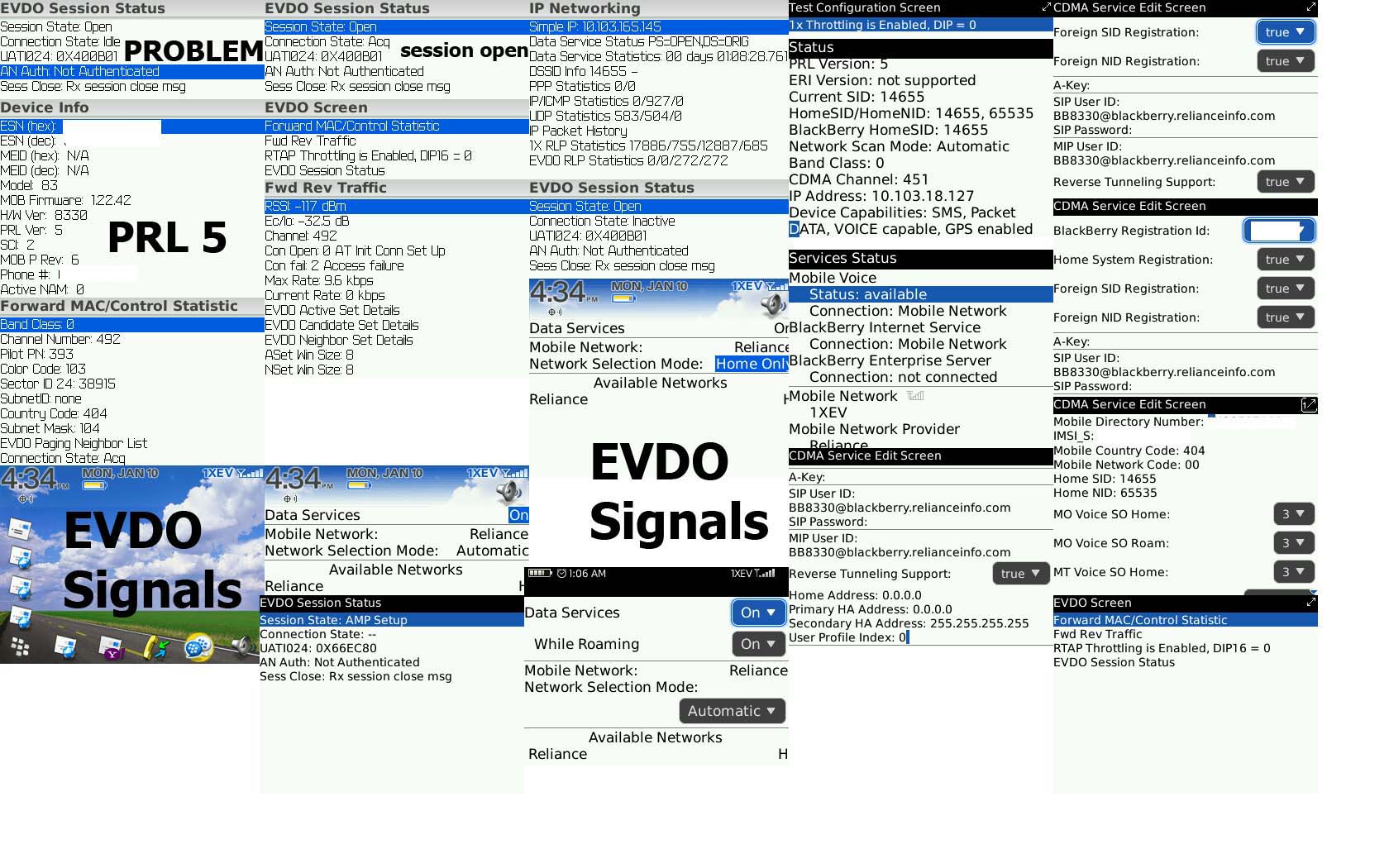

i uploaded PRL Somehow without QxDM only... i am finally seeing 1XEV :D but it fluctuates with 1X :( an d i cannot browse @ 1XEV. Data only @ 1X
pls see the screenshot ..
AN : not auth
throttling enabled on 1x and even RTAP...
pls tell me if some changes to be done from my side
BECASUE THE RELIANCE CUSTOMER CARE HAS FAILED TO PROVID AN AUTH : AUTHENTICATED STATUS :( .... LOOSERS !!
all of you attached the Detailed scpost-73262-0-80791400-1294982827_thumb.jreenshot consisting of all the required info.. pls advice... :) cheers ! thanks :)

One more advancement i could take my issue by myself was understanding the QPST PPP / AN section. Where my username is given as ESN@evdobb.relianceinfo.com
and password is blank as in the screen
so do i need to change those settings? do i need to make it myreliance93number@evdobb.relianceinfo.com ? No na... cos for PPP dialing #777 and user/pass my number is used. even that fetches 1X though so no use :S :(
I am very close to achieving 1XEV AN auth : authenticated and surf on 1XEV network....

Bottom Line AN Auth: Not authenticated/ authentication failed
HELP !!!!
It seems the only thing which needs to be done now is EVDO activation from Reliance Backend...
