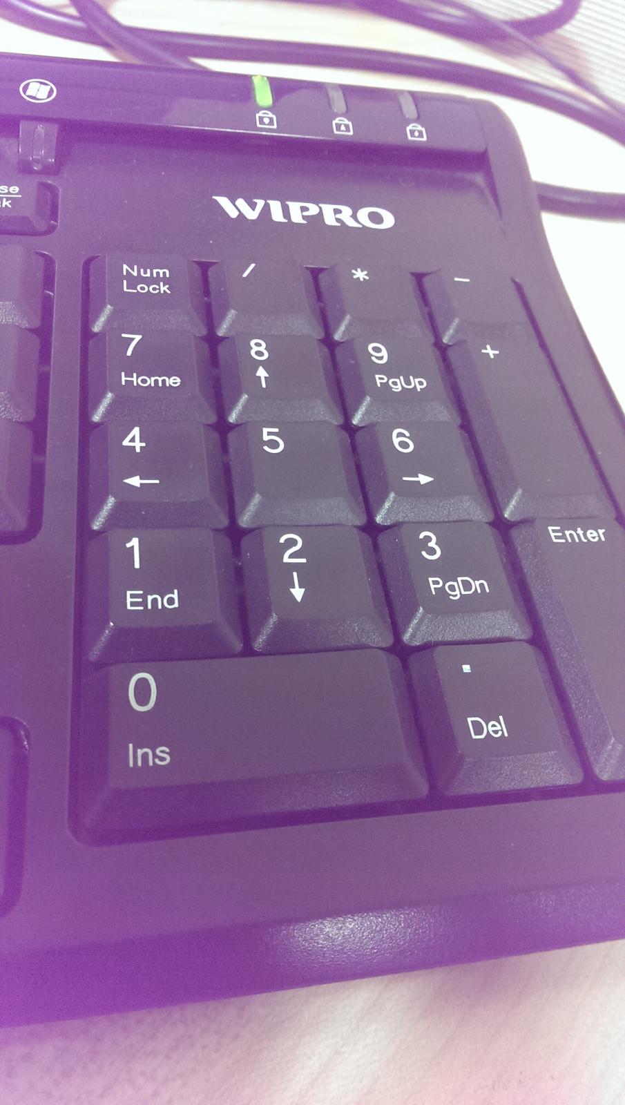

Last week, I bought HTC one dual sim 802D.
In low light conditions, the photos are having a pink shade/tint. Is this a hardware problem or software problem?
I am on Andorid 4.2.2, stock, not rooted.
How to re produce the issue
"To see if your phone is affected, place the camera down on a table and see if the screen goes black, or clouds over with a purple or reddish tint."
Any one else has this issue?
HTC has 15 day replacement warranty, so I need to be quick if its a hardware problem.
If its a software problem, any information about this?
HTC service center will replace the camera Module.

Factory reset usually solves this issue. Otherwise 4.4 Kitkat is also out for most HTC One models. That is also supposedly solving the issue. I don't think its a hardware issue.
Camera tint is hardware problem for sure as i have read lot of posts regarding same. Also this does not qualify for doa, they will replace camera module.
Here's a snap of the issue, even in good lighting conditions.

Even I read its a hardware issue in other forums, replacing the camera module for many has resolved the issue.

Yes, it's a known issue but is solved by a hard reset. Why are you jumping the gun by not first doing a hard reset. If that fails proceed for replacement.
Did factory reset, problem persists.

I think this is hardware issue... Faced the same problem... Bought Htc one single Sim... Google about it... Then came to know its a common problem many people faced it.. And they got replacement... My bad luck I had purchased it without bill so could not claim warranty...

Dont waste more time, get the camera module replaced.

yeah, its a hardware issue. the service guys will replace the camera module. It took HTC a lot of time and a 5000 post thread in xda to admit it as an issue. But now they proactively replace the module.

the only easy way to sort this issue is to keep the phone in the freezer for some time but it will return when the handset becomes hot with usage or replace the camera module :P:

Gave the handset to HTC service center in Hyderabad. They readily accepted it without any hassles.
They said, it should be ready by Monday or with in 5 days.

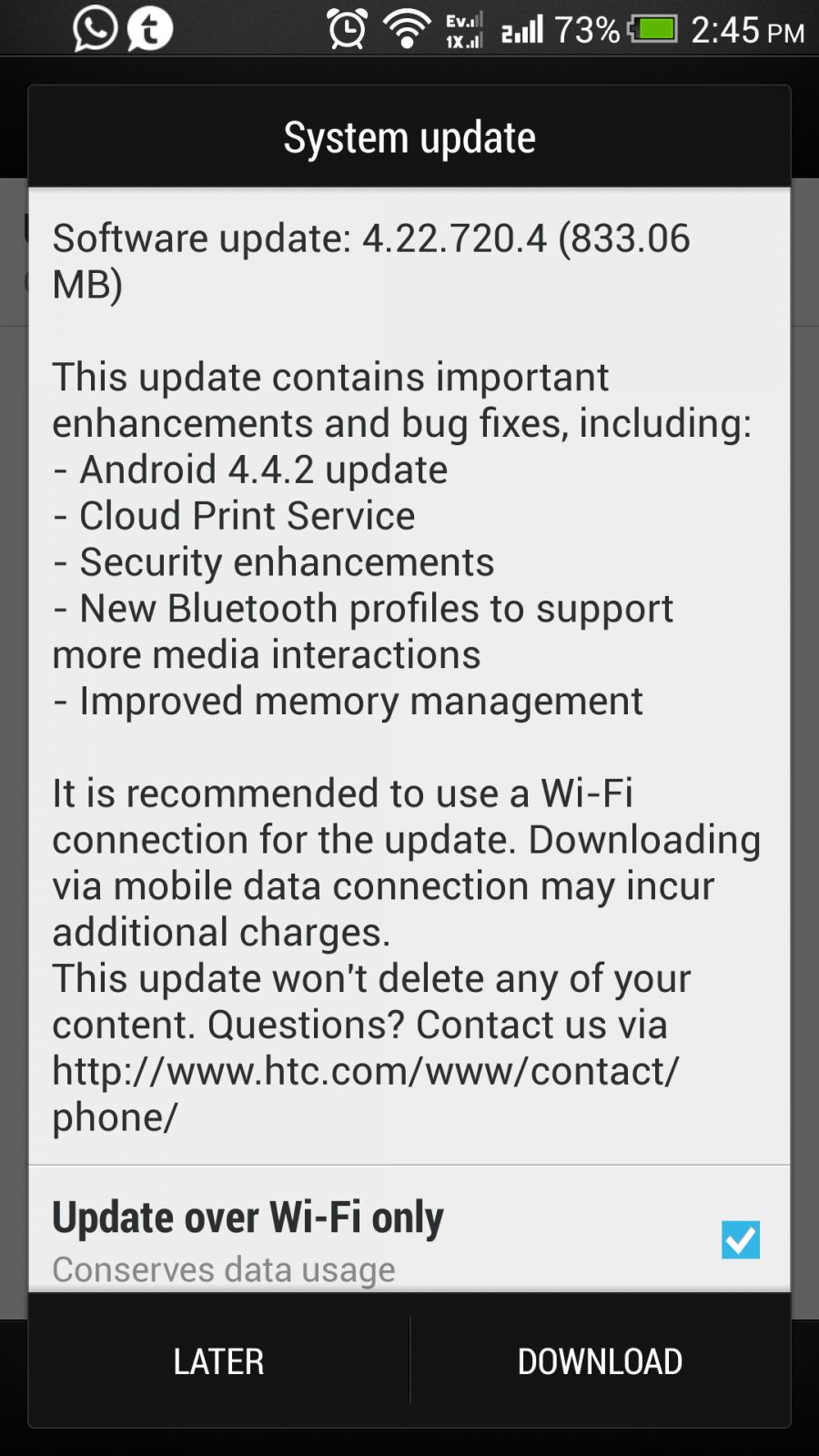

Got the update just now... But i will wait to hear results from my fellow friends who were facing reliance SMS issue if that is resolved.
Mine is working now and i dont want to screw the sms service without knowing the feedack.
Will wait and watch....
Thanks Rajan Ji,
Just checked & now downloading the same. Lets hope this update resolves the sms problem for ever.

yup, its here

Hi Manish,
I am struck, Downloaded the 800MB update but since I am having teamwin recovery installed it takes me to the same & then I am not able to go further or rather not able to find the file which I can manually select for update.
Guru's :- Plz help.
