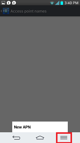

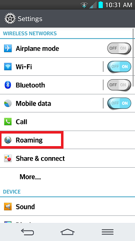

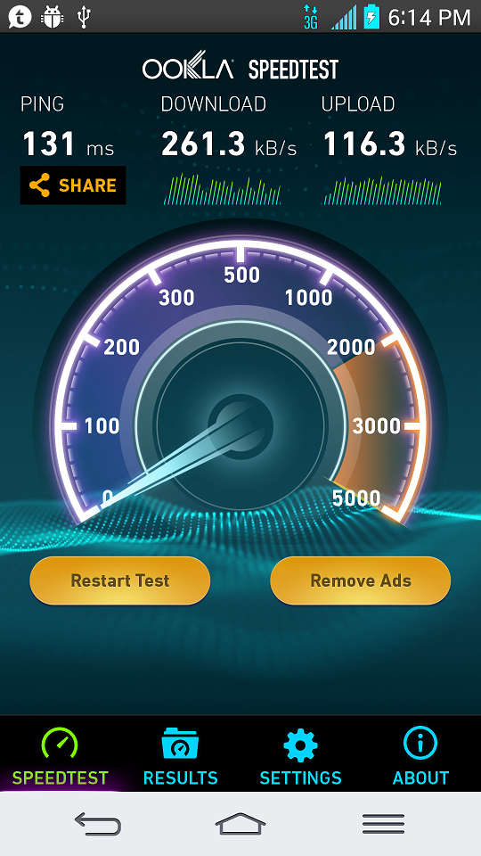

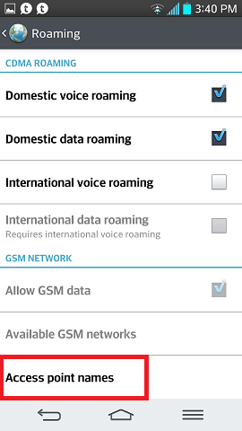

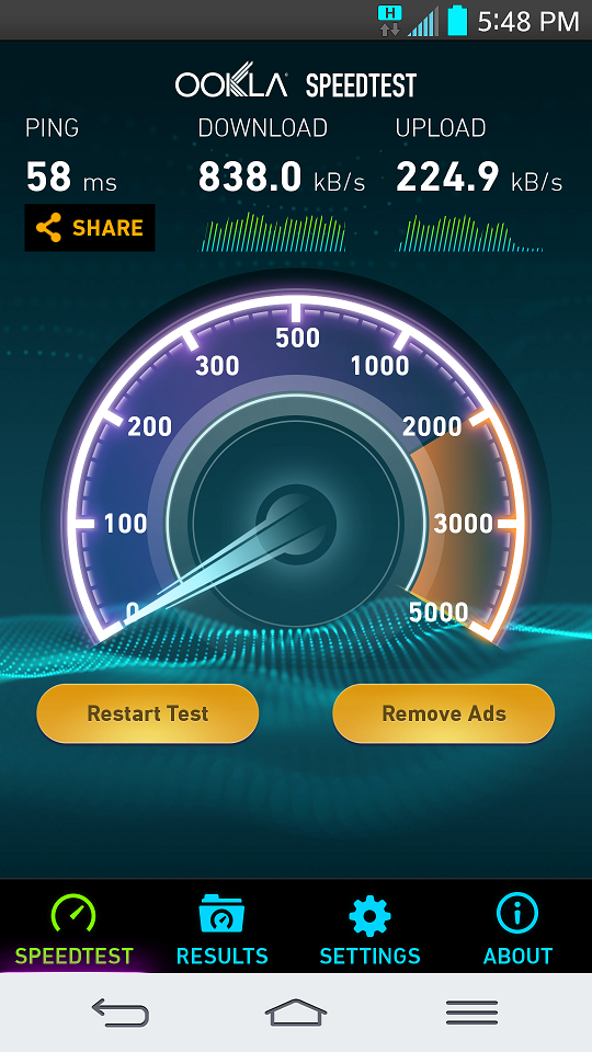

GSM Unlock For LG G2 LS980 has been achieved.
Again this is a permanent GSM unlock for G2 LS980 by Sprint. Data now works on GSM and CDMA (NV) modes.
This is not a build.prop edit or mod unlock for GSM which is only temporary and has issues with WiFI settings and
not able to dial with the use of 0 before any number.
This unlock is complete stock. Enables Rev-B also for CDMA section. Enables Roaming settings and
also most important enables APN settings. Can access WiFi settings without crash, can also dial any number without
the use of 0. COMPLETE UNLOCK.
Phone can 2 numbers one GSM on SIM and CDMA on MEID. Any one active at any given time.
Below are screenshots of working data in GSM and CDMA NV mode with Roaming settings and APN settings.
post-81420-0-87569400-1392561003_thumb.ppost-81420-0-15031200-1392561018_thumb.p
post-81420-0-24804800-1392560984_thumb.ppost-81420-0-22118700-1392560987_thumb.ppost-81420-0-32766500-1392560989_thumb.p
