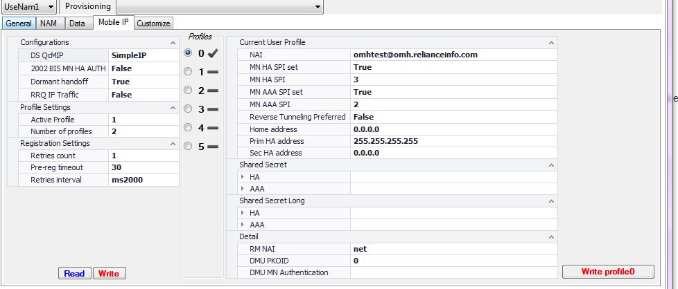

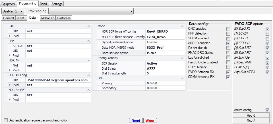

Please Help i am using reliance cdma on my lg tribute as mention in here i've done all the changes i am getting error in while connecting data. Also when i turn on data on reliance it is showing 3G but hardly internet works. I've use DFS tool attached is the screen shot of what changes i've made. Somewhere i am making mistake please advise what to do...
please some help
