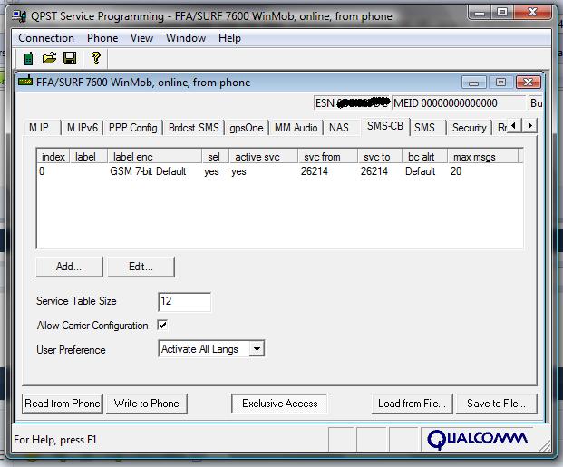

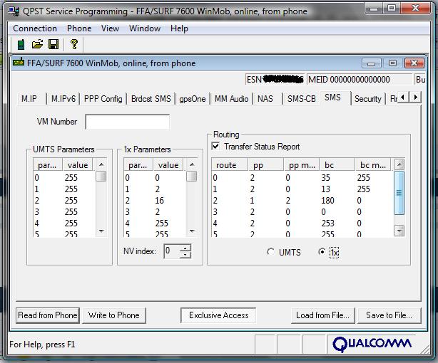

Just connected the phone to QPST and found out that all SID/NID are perfect.. Its just that phone shows just first one in ##786#
These are my settings for SMS tabs, both SMS CB and SMS
hmm , as i said before also i dont think its related to tata programming
