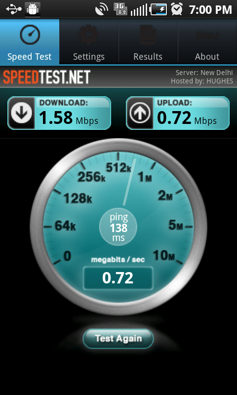

evdo is damn stable here
not once went to 1x
Rom: EC05
