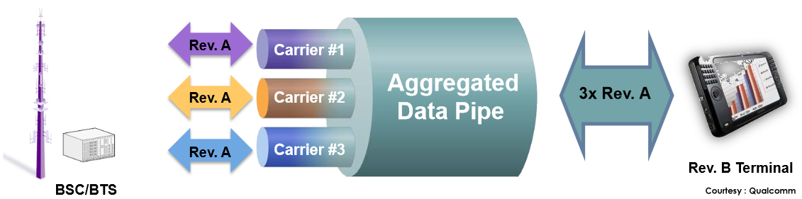

EVDO Rev. B
EV-DO Rev. B is transforming the user experience of millions of EV-DO (HSD/Netconnect) subscribers by bringing Multicarrier (carrier aggregation) and other techniques.
Rev B Works on present CDMA Network using Multicarrier Technique
On Rev A in Use
[[1X]]+[[1X]]+[[1X]]+[[Rev A]]
On Rev B in Use
[[1X]]+[[Rev A]]+[[Rev A]]+[[Rev B]]
Which Free Up Packets for Data rather than for Voice resulting in More Convient to Data Speed.

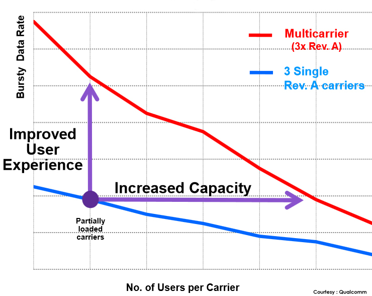

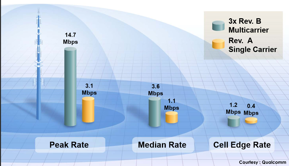

Main Benifits for EVDO Rev. B Users:
> High Data Rates - Downlink Speed upto 14.7Mbps and Upload Speed upto 5.4Mbps
> Very Low Average Latency - Increases Connectivity Between Browser and Web Page Server
> Data Traffic Regulation - BST can Handle More Users along with exsiting REV. A in particular Cell
> Advanced Qos - More Packets can be transfered with in paticular Limit resulting Increasing Download Speed by 2x
Main Benifits for Existing EVDO Rev. A Users:
> High Data Rates - Dowload and Upload Speeds on Rev A will increase by 20% to the present existing Speeds
> Improving Latency - Increases Connectivity Between Browser and Web Page Server
> Enchansed Coverage - Cell Edge Users (Far away from BTS) will be more connectivity with the BST in an Cell
