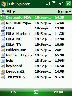

Attached below is the screen shot of language directory, could you please point out the TTS and non-TTS files ?

1 ) By Default Destinator need to be installed on the phone memory !
2) You need not play around with the TSS Files Its by default set to English.
