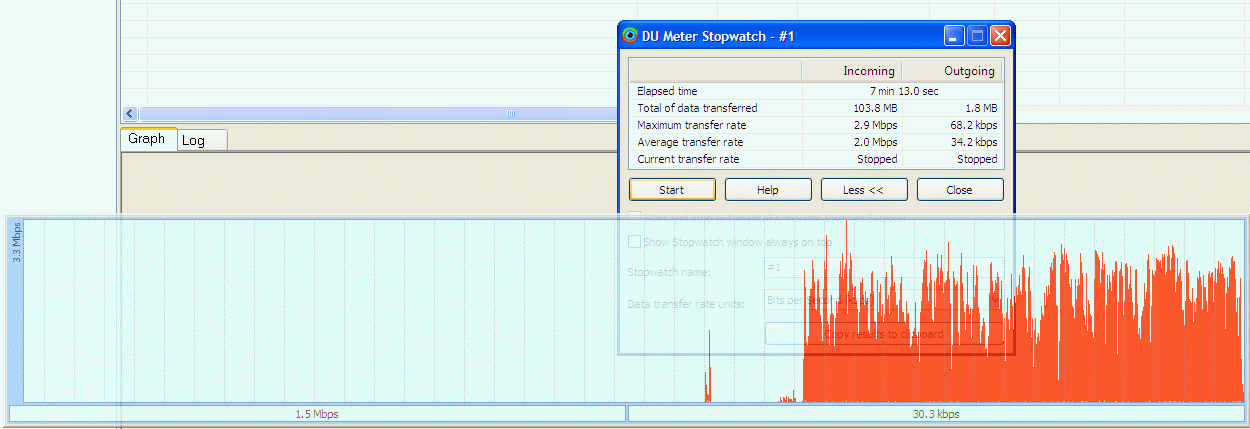

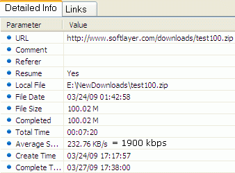

I have done a download test and got the following download speed on Reliance NetConnect Broadband+ with ZTE modem:
I have mentioned the kbps value also in the above screenshot to avoid kilobits and kilobytes confusion
Average speed is about 2 Mbps; on a 3.1 Mbps connection ON THE MOVE, I suppose its OK; should be nearer to the 3.1 Mbps they claim; still pretty great results; Now when will they launch at Meerut?? Only covering major cities at present...
