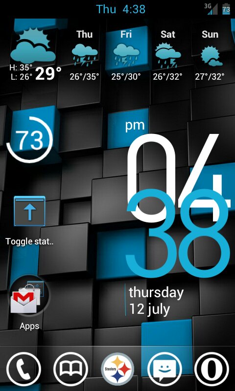

Btw just thought of sharing a homescreen
Sent from my SCH-I500 using Tapatalk 2

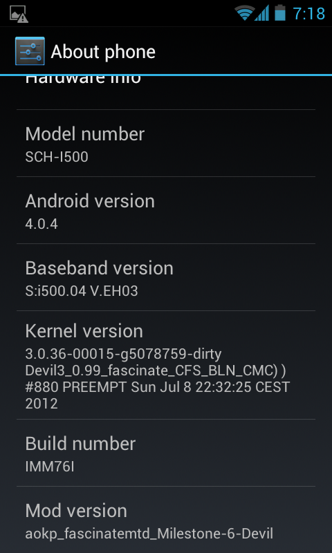

Joshm Install M6 very neatly.
after the restore from Mybackup App+Data It says reboot immediately.
after rebooting it stuck in the AOPK screen at the booting.
Happens,
just wipe all three again and repeat the process as before
After first boot
contacts will be restored from ur gmail account automatically
Thru superbackup restore contacts , sms and logs
And to restore apps, go to external sd folder in card and restore apps from mybackup folder manually, dont use my backup app to restore apps and data this time
But Joshm it stuck in the AOPK screen animation at the booting.
How could I go further ? and it power off only by pull the battery out.
could I go with Three finger...for go to > recovery.
I thing you r right I would take the safest way then.
Flashed stock GB EH03 along with atlas pit and then again flash ICS from the beginning.
At last done it from the scrap.
