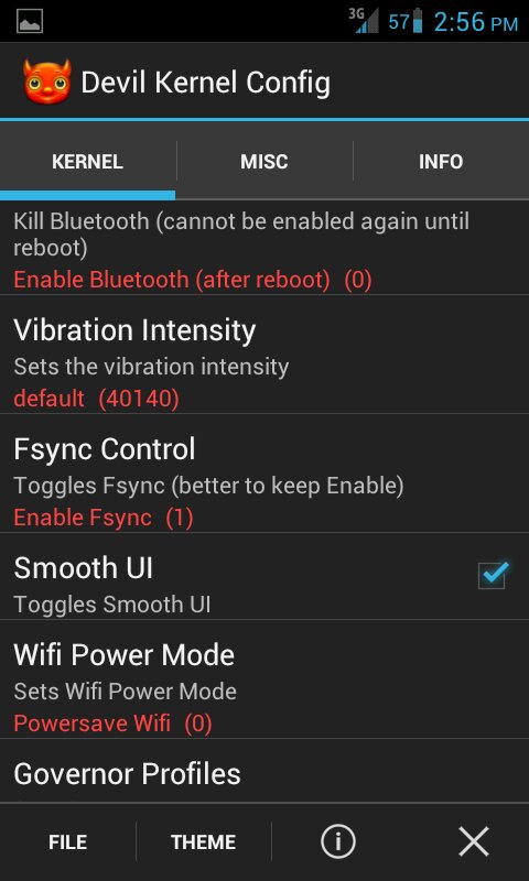

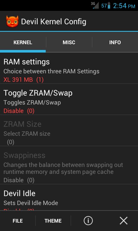

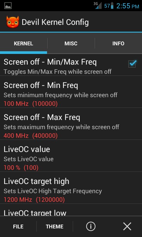

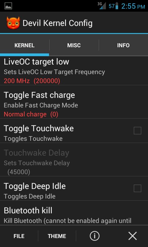

to get better battery performance
i suggest a few full charge ( uninterriupted) and full drain cycles
with a week your batter will be outstanding
also download this app
https://play.google.com/store/apps/details?id=de.hilbring.android.devilkernelconfig&feature=search_result
and set it up like this
Follow these screens
Buttery Smooth THS15 Deviled
