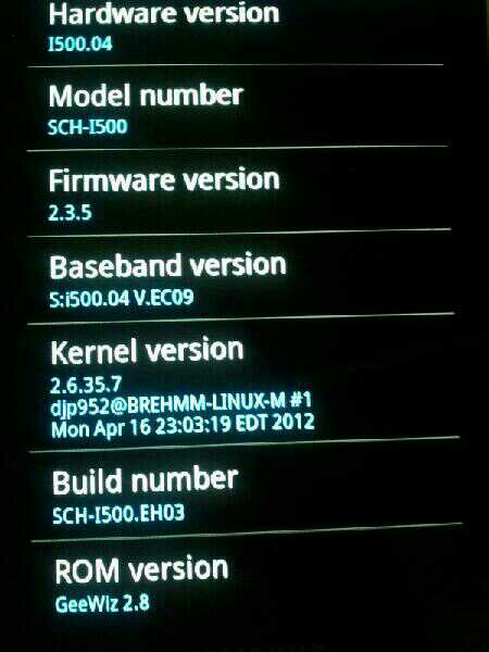

Anyone facing missed call issue with geewiz? I'm getting 3-4 missed calls daily which won't ring but I'd just get notification...
Sent from my Nexus S 4G using Tapatalk 2
