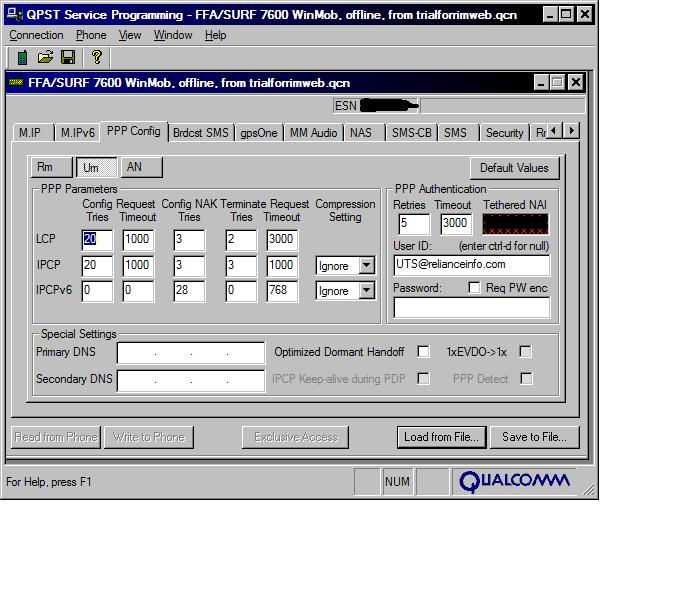

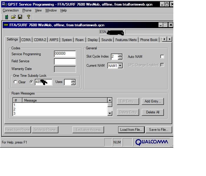

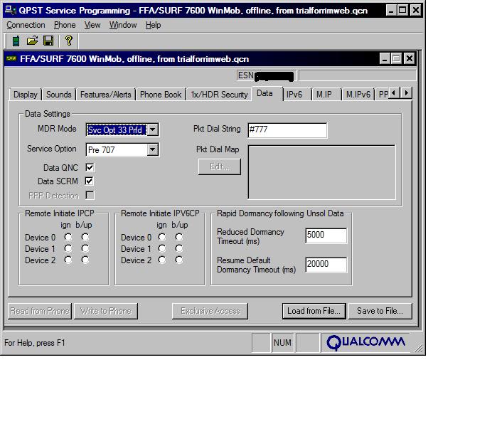

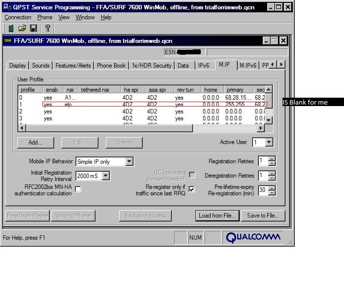

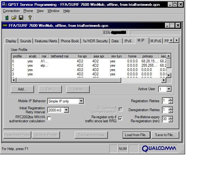

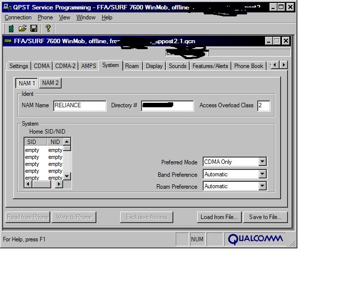

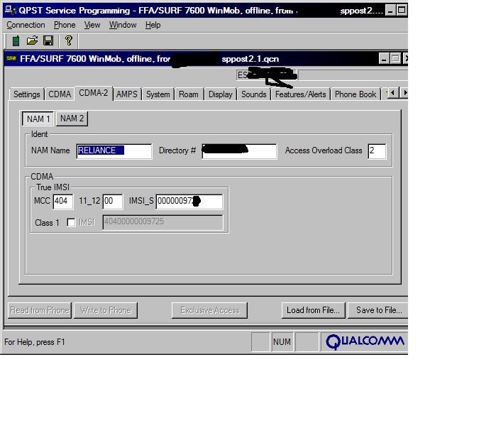

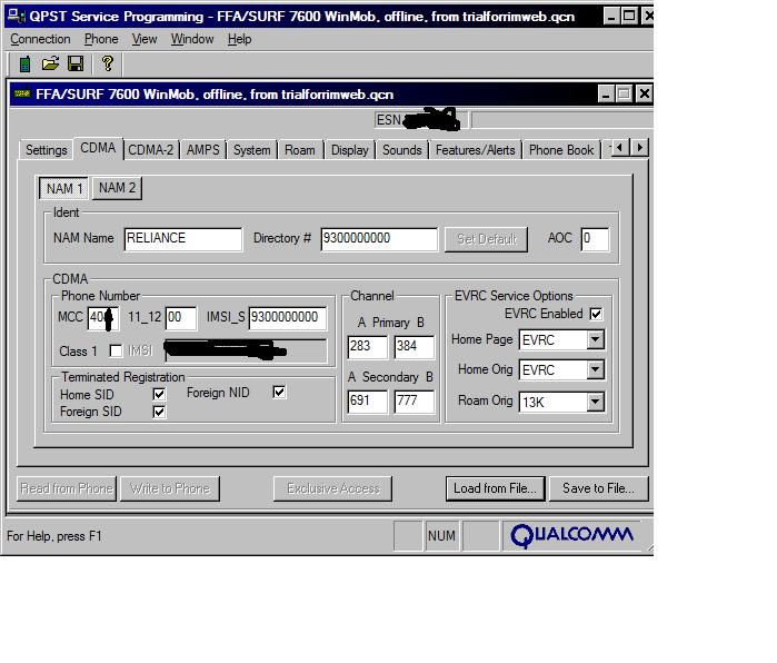

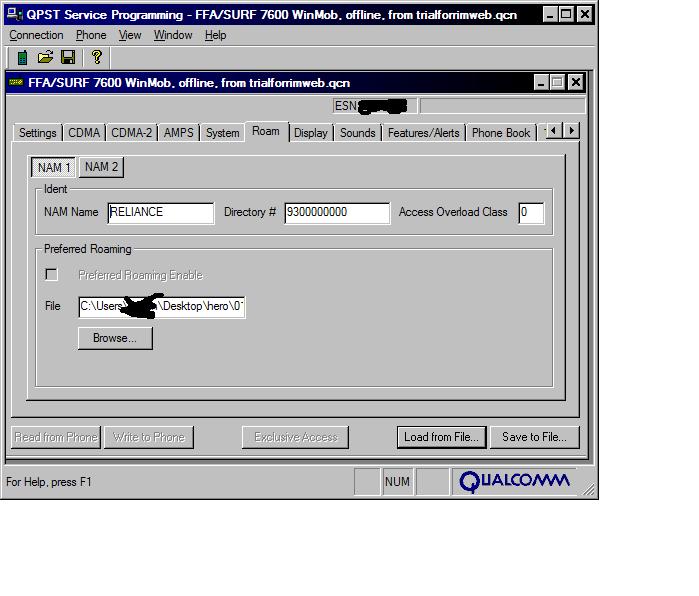

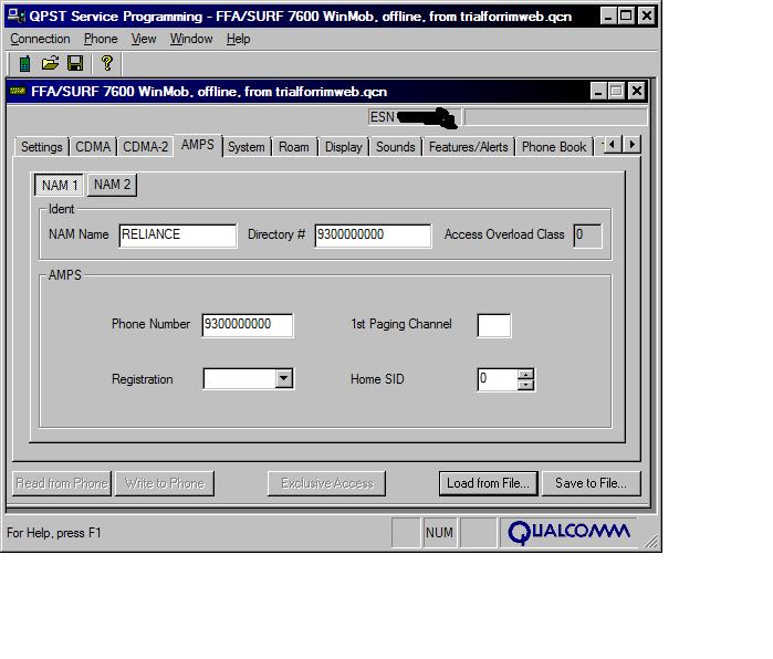

attaching qspt screen shots.. only the relevent ones.. the rest are either blank or just sound n screen settings..hope this helps.dont botther about the mobile numbers etc as i have changed those.
post-21689-127461004467_thumb.jpgpost-21689-127461006782_thumb.jpgpost-21689-127461008416_thumb.jpgpost-21689-127461012197_thumb.jpgpost-21689-127461025827_thumb.jpgpost-21689-127461014544_thumb.jpgpost-21689-127461032182_thumb.jpgpost-21689-127461035056_thumb.jpgpost-21689-127461038546_thumb.jpg

1. Fill SID / NID pair in System tab
2. Change service option to IS-707 from Pre IS-707 in DATA tab
3. in MIP tab delete all proxy and IP addresses to 0.0.0.0
it should connect then
BTW how come QPST reads every thing without error?
Edited by kshah
this is a perfectly working updated 2.1 file.. posted it so people having problems can compare.
Great Job Sunny; baseband is the radio version only.
All others may follow kshah's advice; also fill the first SID/NID pair in systems tab with 14655/65535 value... and username and password in Um tab as shown in the screenshot above corresponding to your reliance data plan and data should work...
Edited by dkaile
i tried matching settings with sunny with sid and nid filled in but did not help.
@dkaile and muffadal,
under the MIP tab in user profile sunny has both the first and second profiles enabled with ip addresses. i have only first active with a blank for the second one, which on editing shows NAI as sprint.
Is it of any significance.
yes, this phone may not connect to network.
Edited by kshah
then can i request sunny to post a screen shot of these setting so i can try applyin to our phones

I did following
1. Change service option to IS-707 from Pre IS-707 in DATA tab
2. in MIP tab delete all proxy and IP addresses to 0.0.0.0
3. in UM i change to my MDN for username and pass as I have windows mobile plan
Thanks to Kshah, Mufaddal, Dkaile, sunny1974 and all others
