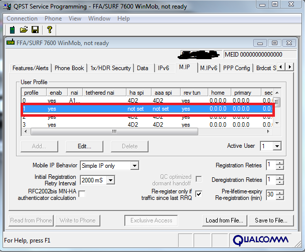

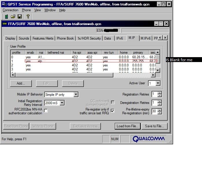

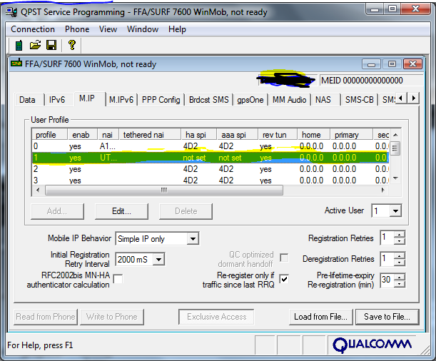

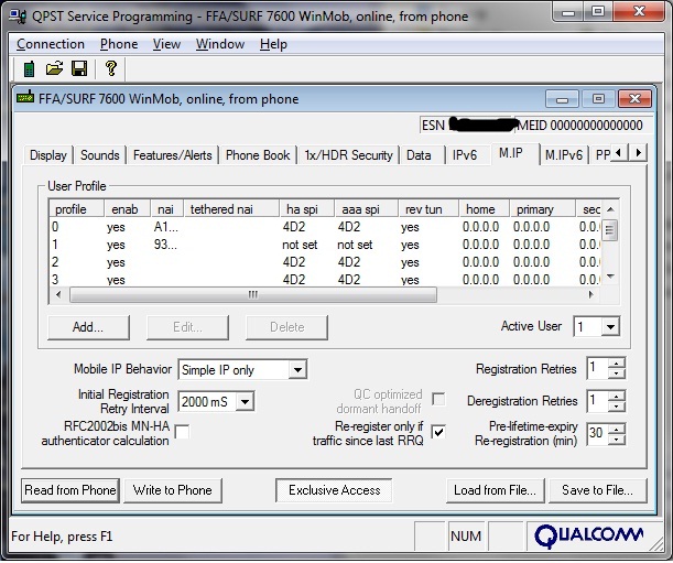

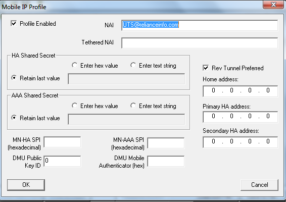

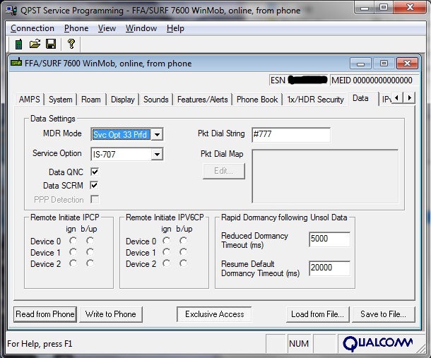

muje nahi bhul jaiyega. I tried as per dpinal but no internet. Again i have noticed that under MIP he has a second profile configured while mine is blank. Kya ye reason hai for my phone not connecting.
I have put screenshots of my setting , pls see and advice
And when i check under the set profile i get this
this is the difference between my phone and both dpinal and sunny. All other setting i have matched and seen but the net refuses to connect.

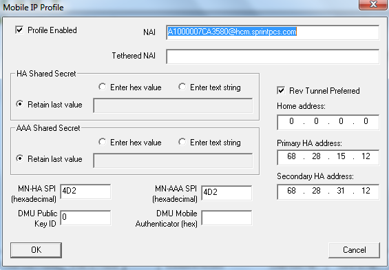

make pri and sec ha all 0.0.0.0 in 3rd screenshot and it will work

I made all of them 0.0.0.0 but its the same no change it doesnt connect. :NOTriste:
Please advice further.
Arrey Bhaiyya Anurag ji; dang se sari settings phir se check karo; kahi na kahi tumne galti kar rakhi hai... Vo theek karte hi sab theek ho jaayega...

write UTS@relianceinfo.com in 2nd profile of MIP tab and leave first row of profile as it is with 0.0.0.0. to all
This will work I guess
Edited by dpinal
My data is working fine now. :grin:

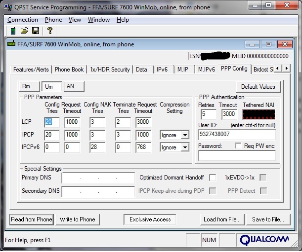

I entered UTS@relianceinfo.com as my NAI in the 1st profile and then configured the rworld username and password in ppp um tab and voila my internet is now working.
