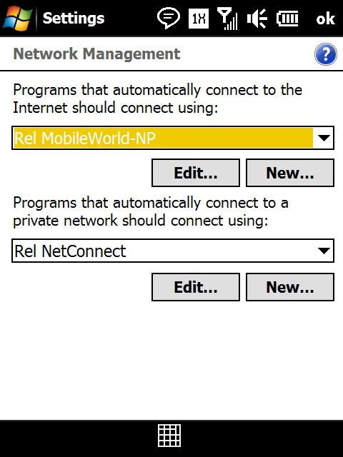

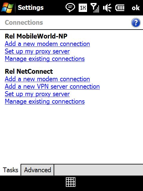

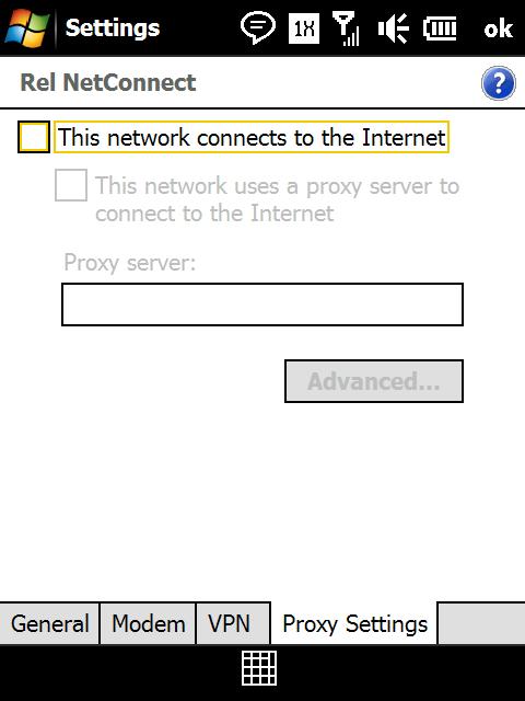

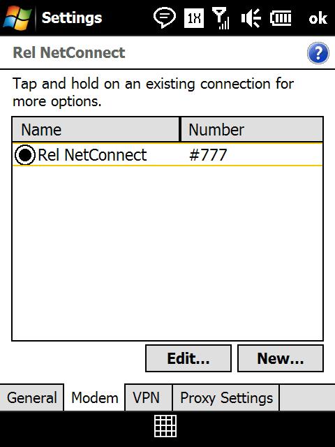

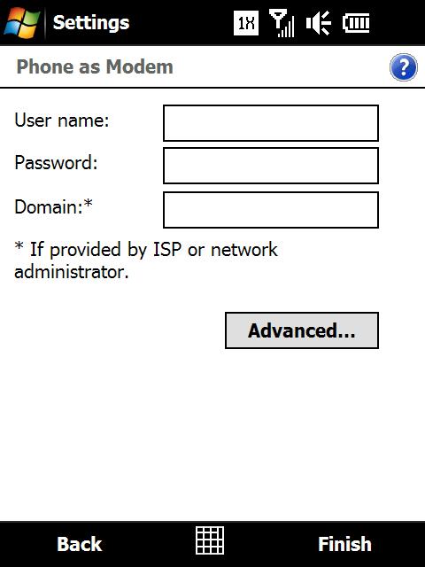

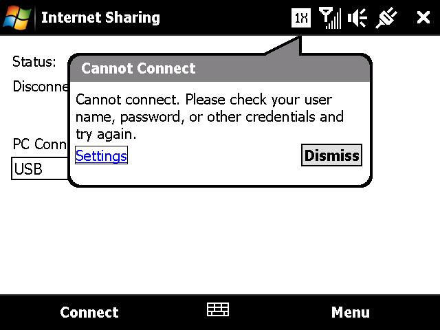

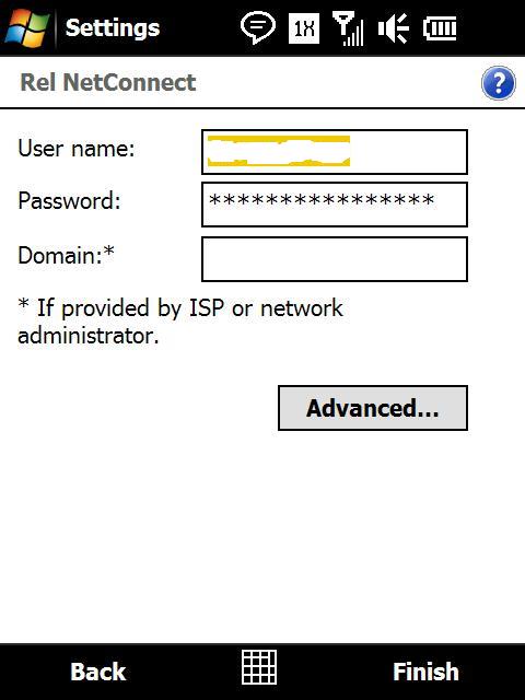

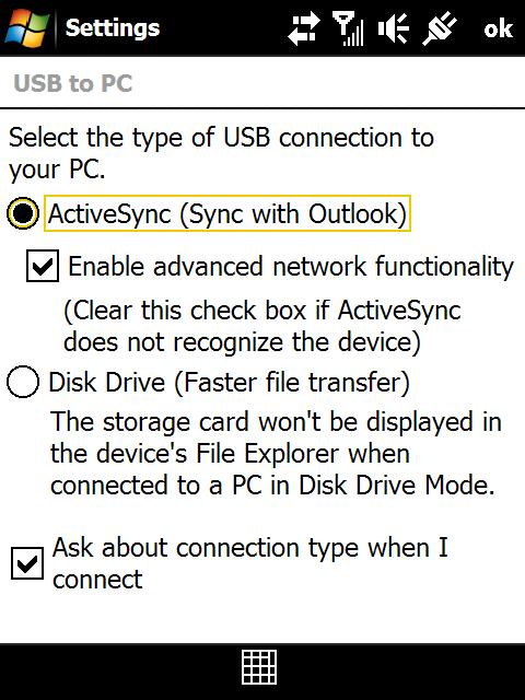

Dear Dhirajji & Dr. Mufaddalji,
I have a problem connecting R-connect to my PC.
I have Spirit Touch Pro on original spirit rom with reliance connection.
I am able to use r-world and r-connect on my phone's browser. But now i want to connect it to the PC, but i am facing problem with that. I have attached some image files of my phone's settings with this post. Can you please tell me the solution for this. I am in urgent need of that.

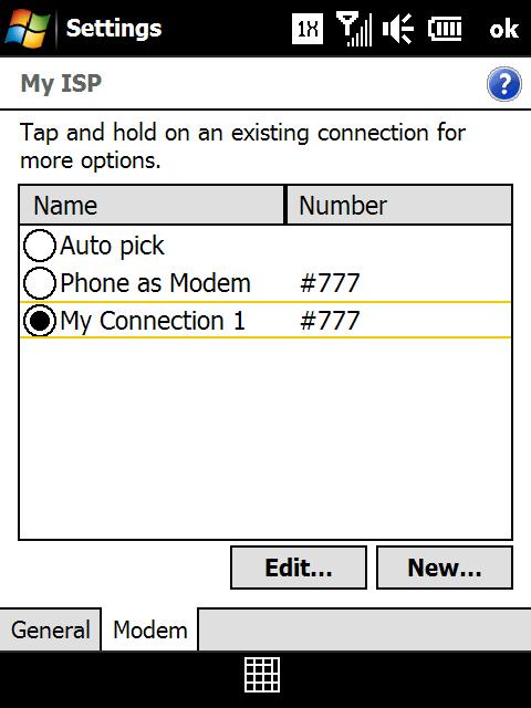

if u wud have read this topic from beginning u wud hv known how to fix it; its resolution was already given earlier; anyways, just go "My ISP" connection and configure it with the username and pw u want (like ur mdn or the uts one; any one u wish) and ur internet sharing will start working...

Dear Dhirajji,
I have gone to "My ISP" settings and have edited the "Phone as Moden" connection and entered the 10 digit MDN as username and password, and then clicked "Finish". But when i again click "Edit...", i found the Username and Password as BLANK.
Then i have created a new connection under "My ISP" as "My Connection 1" and entered the 10 digit MDN as username and password, and then clicked "Finish". Now when i manually click on this connection and click connect, it gets connected.

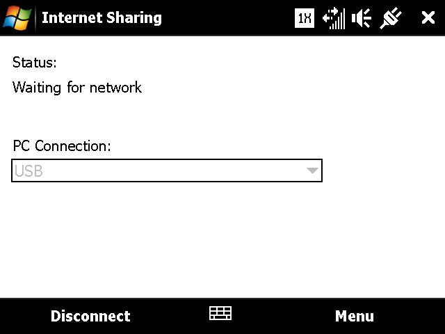

Then i have deleted the "Phone as Modem" connection and then after closing all this, when i go to the "Internet sharing program", it again says check the settings.
But when i revisited the "My ISP" settings, i found that "Phone as Modem" connection comes up again automatically, and also there is one "Auto Pick" Option in "My ISP".

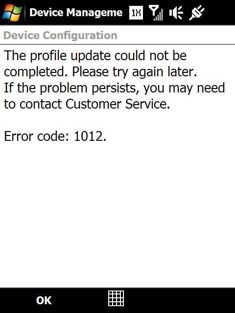

But once while using the "Internet sharing Program", i got one error message for "Device configuration". What is this Profile Update error ???
Please help me, and give me some solution...
- Gondiamail.
the evdo prl has also been posted else where on the forum; anyways, I am posting again (both 1x and high speed/evdo one); up till now there is no use of this prl, except u will start getting Ev sign instead of 1x and you can become :) seeing it..... lol...... no activation etc. is needed and it can be loaded directly from epst or qpst...
I dont have a pro with me now, and now am on hero...
but u shudnt have deleted the phone as modem connection; btw, the shots posted by you are not of the latest original sprint rom of pro;
Under my ISP, just let there be 1 connection i.e. phone as modem and edit it to put your mdn etc. It will connect by default only with phone as modem... also make sure u have replaced htc_cm guardian.exe file with blank 0kb one and deleted the sprint connections.... these are basics which i cant repeat over and over again.... read the topic fully... also ignore any profile update errors...
