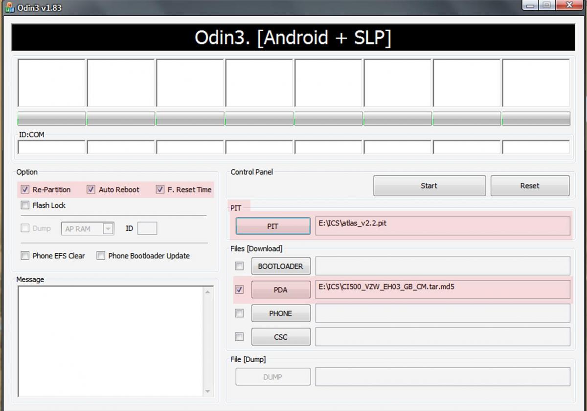

@ Amit : when u are flashing the stock EH03 in the PDA option, at the same time in the pit option select the atlas pit and side by side check the REPARTITION option
and hit start
@ Joshm : as you told, the procedure of flashing stock EH03 with Atlas pit. I have attach a screen shot of it before going to flash.

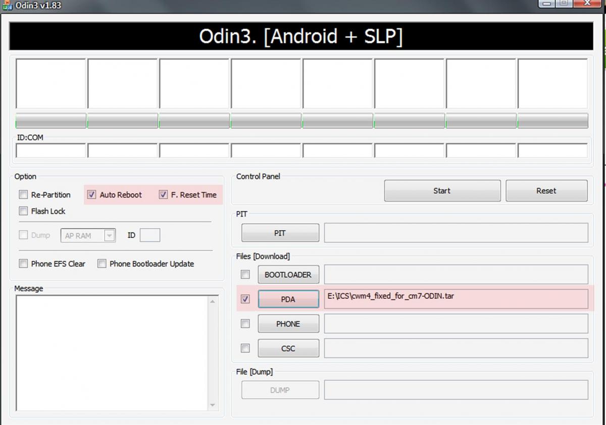

also attach a screen shot of step no. 4.
plz tell me if any thing going wrong.

The first screen is correct,
And yes the lsnguage screen crap always happens when ur mdn aka cell no is not fed into the memory.
If you have already got it done then you prolly wont face the issue anymore.

@ Joshm : thanx for simplifying everything. Is there any thing wrong with the step no. 4. You are not mention about it.
plz tell me if any thing wrong.:mellow:
regards,
Sent from my SCH-I500 using Tapatalk
Who said there is anything wrong?
After flashing eh03 you should boot, shutdown, go in download mode and flash the mentioned recovery to proceed.
This is a tweaked recovery which helps flashing the ics builds

Dear Joshm,
I am talking about my 2nd screen shot. Which is about the step no. 4.

yes thats correct , thats how you ll flash the recovery after putting ur phone in download mode.
