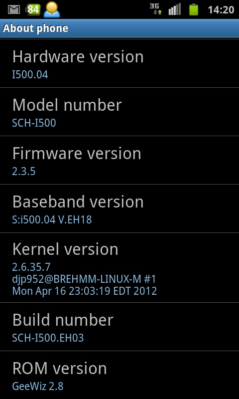

@joshm.........
1) Kindly refer to the image, the baseband version on my phone still shows EH18. I think it should have been EH03 as i had directly flashed geewiz 2.8 rom & kernal on EH18 setup. Do i need to do any changes?
2) If i have to flash FC27 radio ( just the radio), can i directly flash it on this setup?
3) The ICS guide is tempting me to upgrade again but i think i will wait for some more time, i guess, maybe till weekend to get myself acquainted with the procedure.
@renuka,.... happy to help Anytime.... I learned this from the Rimweb community .......they have been always soooo helpfull... :-) :Sorprendido:
