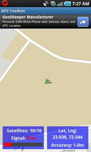

Gps is perfect I. Dk28. Better accuracy tghan dk18 but takes longer to latch than dk18. Froyo has typical screen update lag which I dislike.

See GPS accuracy on my Dk-28
